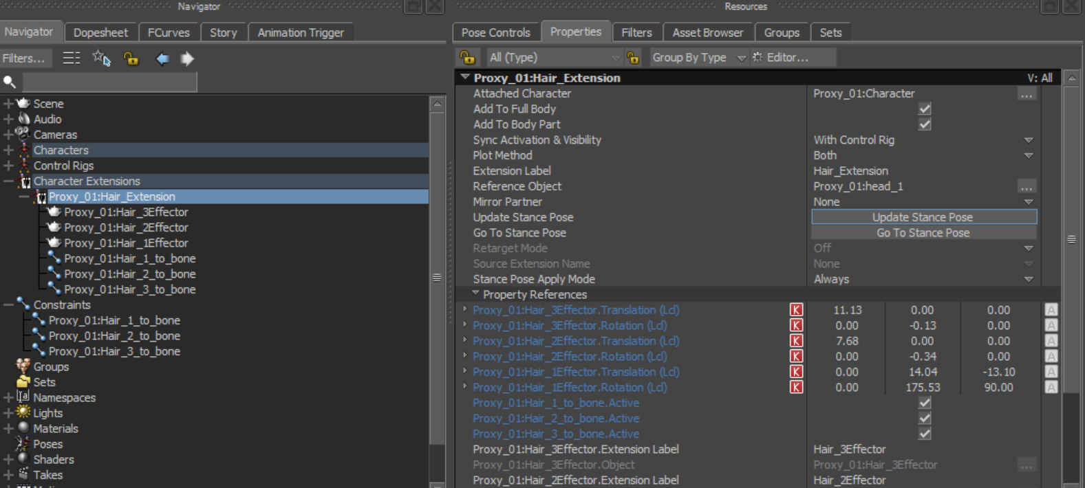

My example below is just some animation on a pony tail. I made some markers which control the joints via relation constraints. I made a Character_Extension and added the markers and the constraints to. When I switch the source to control rig the extension shows up and when it’s set to none the extension hides it self. Maybe it’s not handling the constraint weight? Or do I have to setup another extension for the bones? I know I’m missing something.

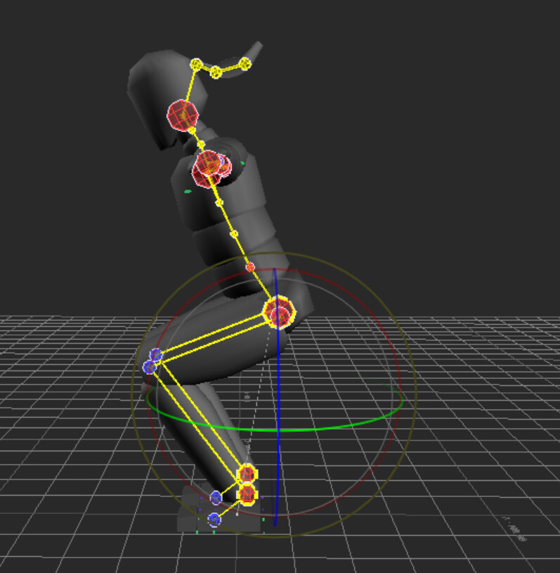

Here’s an example pose.
After plotting to Control Rig.
