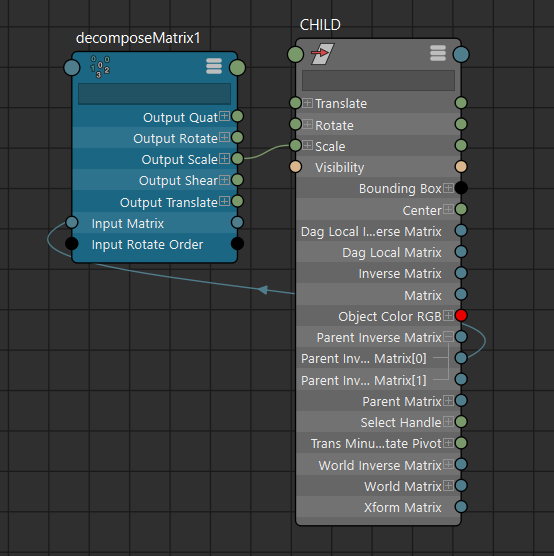

They do, but the reason you’re seeing that behavior on joints is because of the segment scale compensation setting, which uses that inverseScale plug and is enabled by default on joints. The purpose of it is to remove shearing from joints without affecting their position.
To mimic the behavior of segment-scale-compensated joints, you want the scale that has been propagated to the child removed so there is no shearing, but you still need the parent scale to propagate in some way or otherwise the child will appear not to move, because you need the scale to affect the child’s position.
The simplest way to do this is to allow scale to propagate through parenting, then remove the scale from the child’s local scale channels at the end by only applying the scale component of its parent inverse matrix. You can get that by decomposing the matrix.

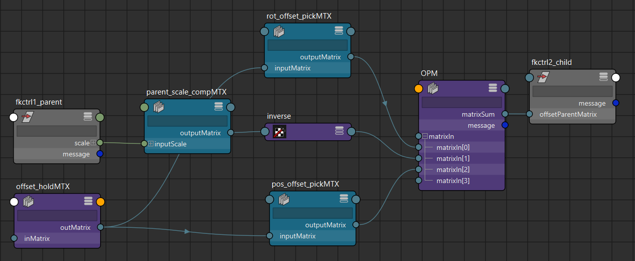

I wasn’t able to get exactly what I want from your suggestion with that simple connection but you sparked an idea with the “undo mtx” and I think I got something that seems to work:
I want all the channels of fkctrl2 to be 0, that’s why there’s the offset matrix. And I found out it was crucial to split the rotation and translation of the offset in order to apply the inverseScale from the parent in between.
i.e. OPM = rotationOffset * invScale * translationOffset
in my script I will not need the offset matrix nodes and will just setAttr() on the OPM node instead. They are static matrixes. Only the scale from the parent is a live connection.
I was not able to get the correct scaleMatrix from the parent using the inverseMatrix output. Because the rotation causes shearing that I can’t remove with a pickMatrix. That’s why I composeMtx and invert it instead.
Does this make sense? Is there a better way to do it?
That sounds right. Doing this operation in code would look pretty similar. You have to build the matrix in that particular order to get the behavior you want without scale affecting anything else.
