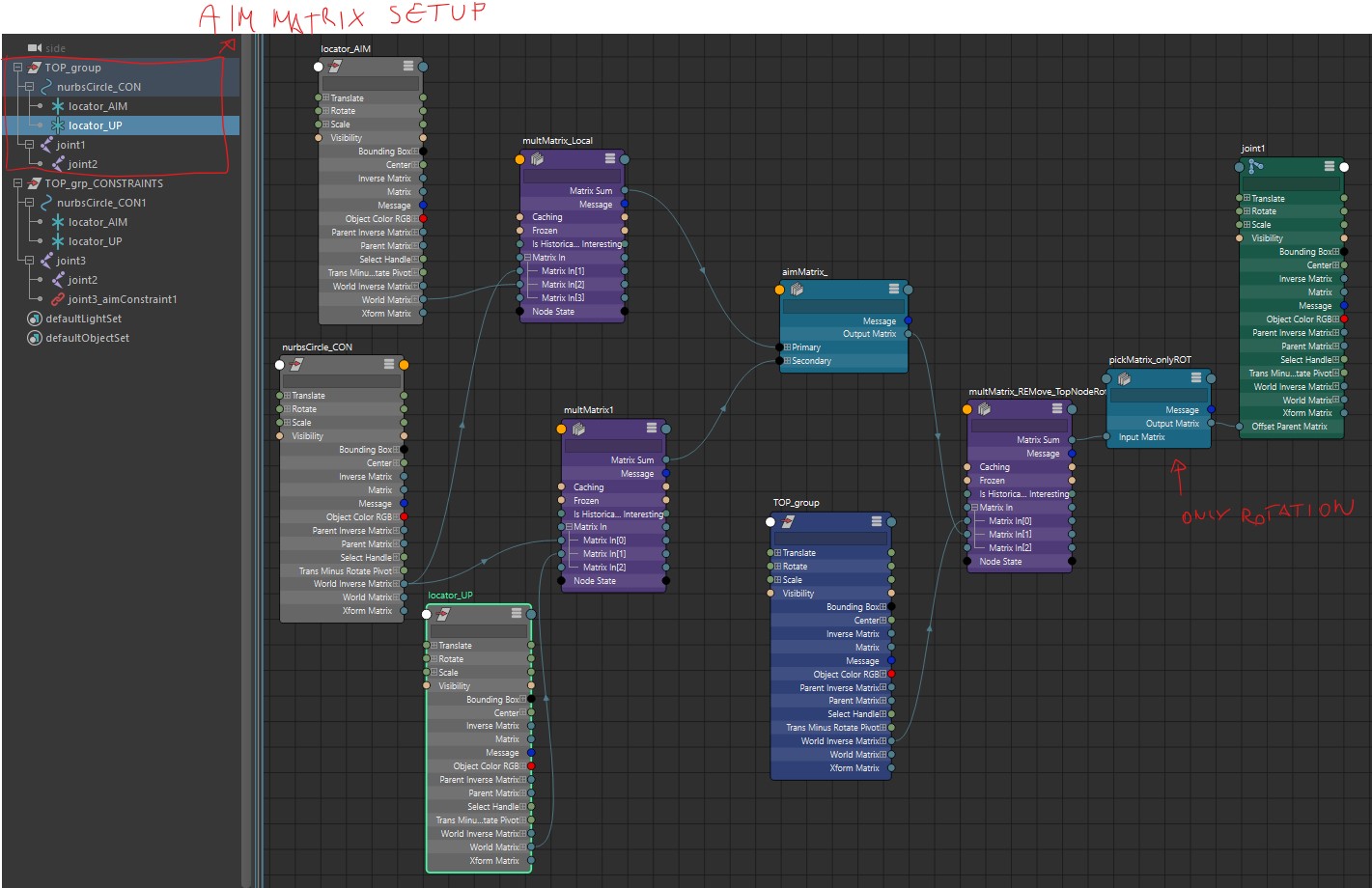

Hey there, i wanted to re-create this super simple rig which i had made using a regular AIM constraint, but using the new AIM matrix node in maya.
I am having some weird issues , when the matrix rig, top group gets rotated at an angle, the Aiming object starts to go balistic and rotates in all sorts of wrong ways.
I provide a simple scene with the two rigs (there is animation onto it, so you can see what im talking about).
I am fairly sure i am messing up something…but i can’t quite figure out what it is.
How can i achieve the exact same behaviour of the Aim constraint, onto the Aim Node rig ? (i would like to keep the exact same hierarchies, unless is impossible and needs to be adjusted a different way)
Also, what do you guys think of this new node? I am not sure is any faster then the old constraint (nor any less nodes tbh…)
You’re doing some things that would be smart for a more complicated setup, but you should try to just get it working first with simpler connections.
So first, don’t worry about doing this in local space. Just plug the world matrices of your nodes into the aimMatrix.
Second, you’re missing a connection. You have to have a matrix that tells the aimMatrix node where you’re aiming from, and that’s the .inputMatrix plug. Basically, with this setup you’ve gotta have an extra transform above the node that you want aimed.
Try starting from that and making it more complicated from there.
And since you asked, I absolutely LOVE all these new low-level toys that maya has been getting recently. Maya has needed this low level stuff forever. IMO In the past, so many of maya’s yearly improvements are either trying to lower startup friction or impress investors. But they’ve done precious little to make things easier for more knowledgeable technical users until recently.
With these matrix nodes I don’t have to continually compose/decompose matrices all over the place to do the cool stuff. And, especially for more complicated setups, I don’t have to have extra nodes/constraints all over the place. I can usually get away with a multiply or three, and a connection to the .opm.

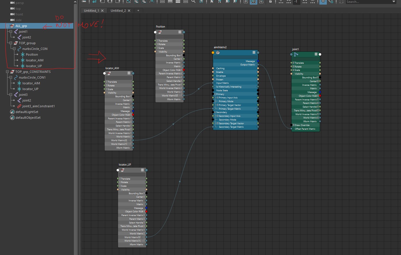

Yay! @tfox_TD , thanks for the quick response!
I was definitely missing something here, the Position locator did the trick!
I had to also re-organize my hierarchy given the double transform on the joints, but not a big deal.
My question was more in specific about this AIM matrix constraint (i couldn’t find much info on how to make it work properly ), i definitely am VERY appreciative of the new matrix nodes and offset parent matrix connection being available!
I wonder, have you tried comparing a rig using constraints, and the same rig using matrices?
wonder if there is a speed improvement , for sure the connections needed are going to be less.
I ended up with this solution, and does behaves as i would expect, with just 1 node(and fewer connections).
