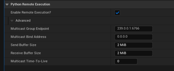

here is the UE5 python remote execution api setting:
Screenshot 2023-09-05 113106
when I run this script in maya, I got an error in UE5:
LogPythonRemoteExecution: Error: Failed to read remote execution message ‘print(‘hellow world!’)’: Failed to deserialize json object! Invalid Json Token. Line: 1 Ch: 1
