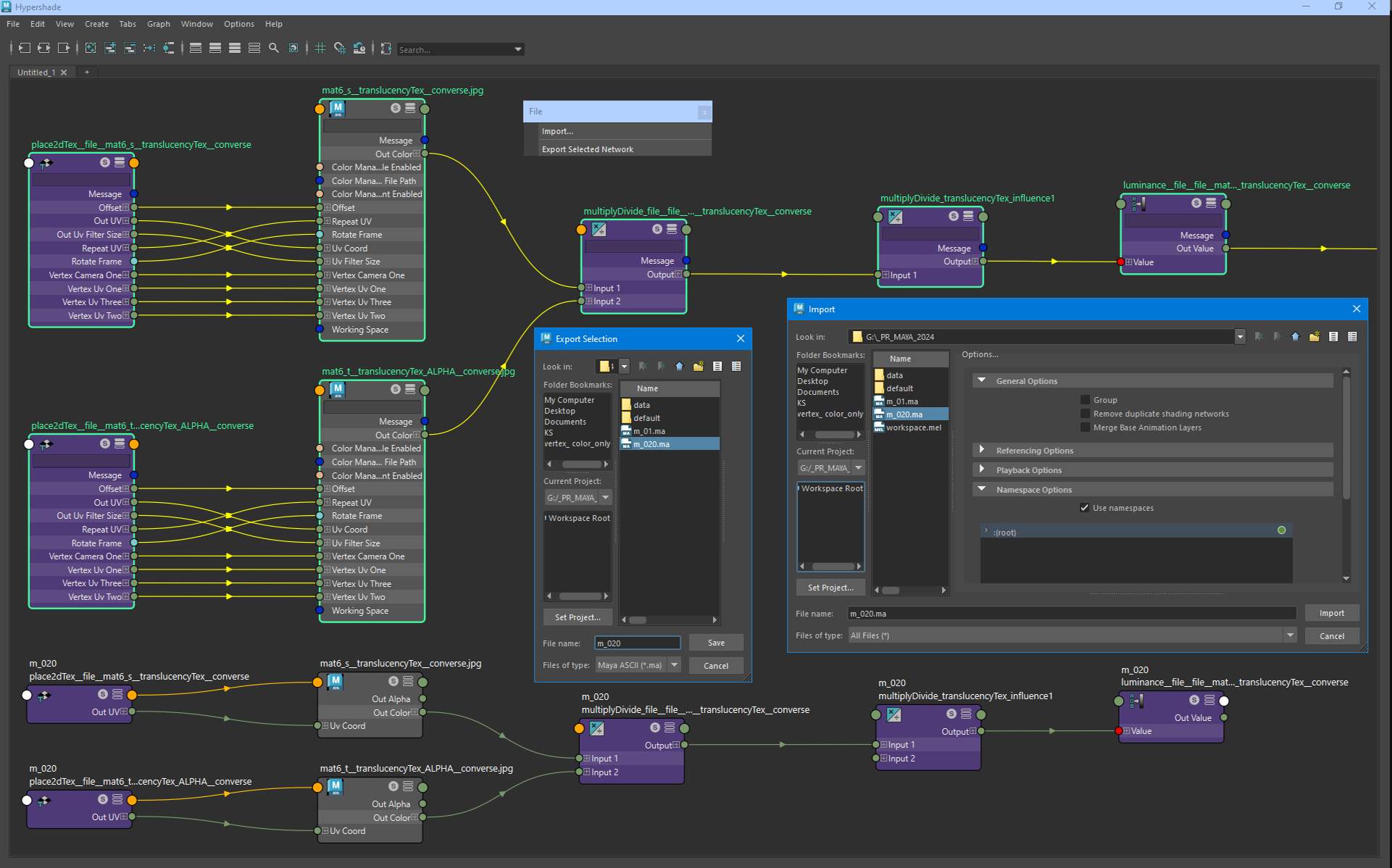

hi everyone, here I am with another question related to Maya pymel.
Is it possible to automatically create a node editor structure like this through pymel?
Is there any way to copy the whole thing and turn it directly into a script?

thanks for the answer! Yes surely is possible remap the whole structure of a node into a dictionary,
the real question is:
Is there any way (command, library, etc…) to do it automatically.
There is no ‘out of the box’ solution, if that is what you are asking for.
Looks like @VVVSLAVA proved me wrong. I didn’t understand that exporting to .ma was an option
Yes, such a commands exists
For example:
File → Export Selection Network
Maya ASCII(*.ma)
File → Import...
If you need a script, then the m_020.ma file is essentially a MEL script
Good luck!
