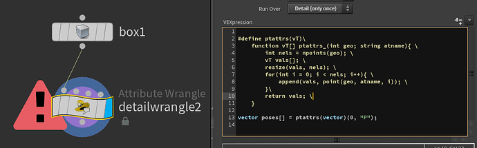

I’m hitting some frustrations trying to work with attribute data in custom functions - I also have limited understanding of C-style templating, but it seems like a limitation with how VEX is parsed.
In my case, I want to get an array of all the attribute values of points in geometry - here just “P”. But this attribute could be anything, and therefore could return an array of any type.
wrangle code:
#define ptattrs(vT)\
function vT[] ptattrs_(int geo; string atname){ \
int nels = npoints(geo); \
vT vals[]; \
resize(vals, nels); \
for(int i = 0; i < nels; i++){ \
append(vals, point(geo, atname, i)); \
return vals; \
vector poses[] = ptattrs(vector)(0, "P");
I think the issue here is that I’m trying to declare and then call a function in the same line, which is just invalid syntax once it’s all expanded.
Is there a better way to format/structure this in a library? This hopefully won’t be the only example, so manually typing out variants of the function for every vex value type is not appealing.
