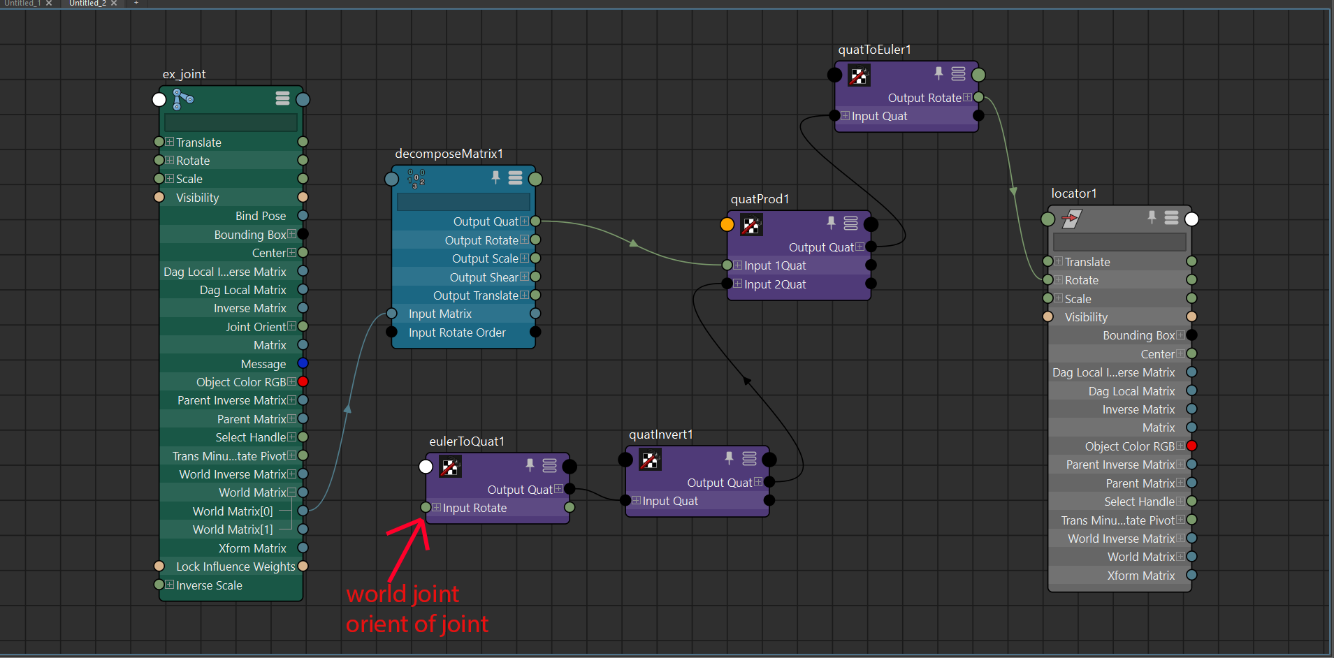

While using matrix in Maya there is a problem with joints. You know when taking a matrix from a joint, for the rotation values it gives joint orient before the actual rotation. I know a technique to solve this but i’m not sure if i should do this instead of an constraint node. There is a picture of setup. And is there an another way for solving this problem? I can maybe write a plugin to make these in a node, but i’m asking for vanilla Maya.

Try not to optimize unless you’ve got a reason. And definitely don’t do it without actually testing which is better.
Constraint nodes are built-in, simple to make, and (very VERY importantly) simple to debug later down the line. If they solve your problem, then using them is a great solution.
But if you profile your setup with constraints, and you can see the constraints are causing a big slowdown, and you test with your setup above, and you get a significant boost, then it may be worth doing it that way.

Another solution is to just not use joints. Especially now that we’ve got the .offsetParentMatrix plug in the regular transform node, I see fewer and fewer reasons to ever use joints. Of course, I don’t know your use-case (you may have some game engine exporter that requires joints), but if you can just use transforms and not have to use 5 extra nodes to get data that already exists, then I say use transforms.
Ok, thanks. I have understood what i’m going to do.
