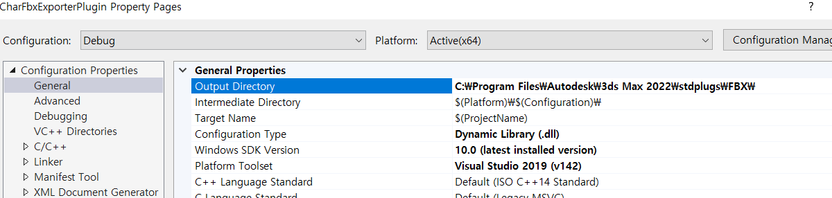

HI all,
I am currently creating FBX extension plugin to export custom data form max. but it doesn’t work. I think I made mistake but I’m not sure what it is.
Does anyone have any experience with this?
blow are tools and sdk that I am using
- visual studio 2019
- 3ds max 2022
-3ds max 2022 sdk
-fbx extension sdk (2020.2.1)
