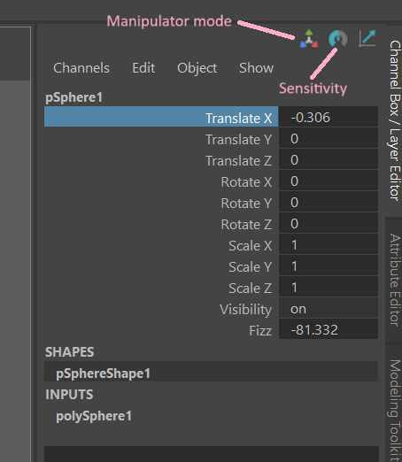

At the top of the Channel Box, there’s three icons. The tripod-looking one on the left is the Manipulator mode toggle, and the one in the middle is the Sensitivity.
The sensitivity toggle will work with non-transform attributes by default. So if you have a custom float attribute (like “fizz” in the example image), left-click on the attribute name, and then middle-mouse-drag in the viewport, the sensitivity button will let you toggle through 4 sensitivity levels when dragging.
For transform attributes (like translateX), the sensitivity level only seems to work when you set the Manipulator mode to “Invisible Manipulator”. With the manipulator mode set to “invisible manipulator”, and the sensitivity set to the lowest setting, click on the transform attribute name in the channel box, then middle-mouse-drag in the viewport, and it should be changing the value at a slower rate than normal.
I was operating entirely unde the wrong impression with that button you point to.
For the longest time, I thought the modfiers, shift or ctrl, performed the exact same function as that button, so I figured, I could just leave the button some random state, and use the modifiers while holding MMB to modify on the go.
From my new understanding, that Icons functionality is essentially a frequency rate, if set to 0.01, it will essentially add 0.01 to the attributes current value. It seems to be using the spped flag of the channelBox command, and its possible to set it to any number.
