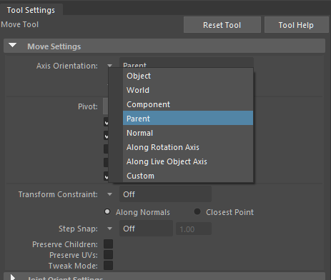

When you say parent mode, which one is that ?
In the tool settings with the translate/move tool active, under the axis orientation dropdown, the one that says “Parent”
Thanks ! Im running Maya 2019 and don’t have the parent option under axis orientations.
