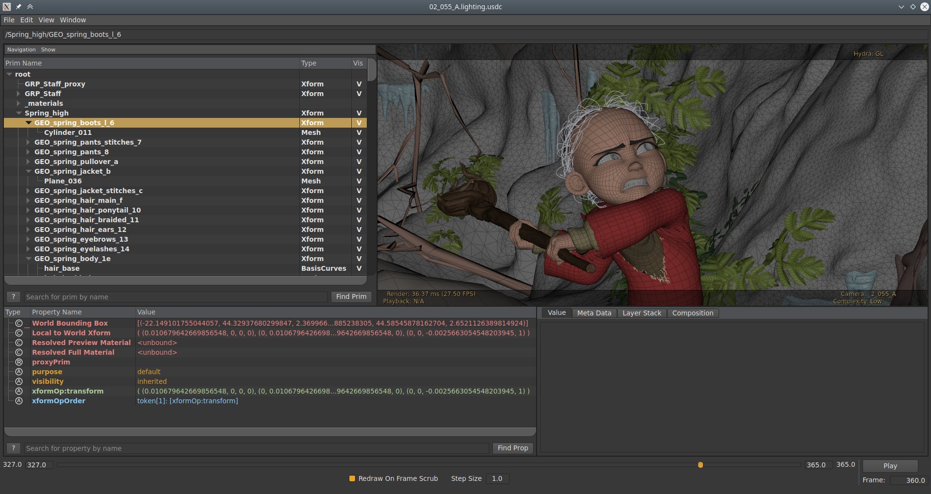

@il_berna: This USD stuff looks interesting but I have to admit… I still didn’t got it completely.
I mean, I tried a little to read what it is and what it does, but I have problems understanding it.
Maybe because I’ve never worked in the vfx or movie industry but in a relatively small gaming company.
USD seems to me an extremely complicated tool for our usual needs (basically assets export) and I really don’t see how it could fit in a pipeline like ours.
But I like the idea of an open format…
@David_Rhodes: Well, besides being open, it’s much faster than Fbx. That said, it doesn’t just represent individual assets—they are entire scenes with data separated as granular as you need/want. Variants, layers, nested references; these are very cool concepts.
Most game engines are not yet taking advantage USD, unfortunately. But imagine building entire levels or parts of levels in a DCC as an artist (looking at Solaris) and having designers work on their own layers in game editor and merging the two seamlessly (with intuitive conflict resolution).
@il_berna: Yes I’ve seen that it can basically contains full scenes with a lot of informations. It only seems to me that it’s way too much for basic small gaming field use… so I’m not sure if it could be worth the probably long time to understand,implement and try to use it
FBX is doing good atm for us, but in some cases it was actually slow and clunky:smile:

@dhruv: So just a couple things:
usd can describe small assets as well. It’s just a data description and composition format at the end of the day. Anything you can describe in collada, fbx, alembic, JSON, XML etc can be described in USD
USD allows for a few things that alembic and fbx don’t, namely composition. That means anything from simple referencing and hierarchy, to overriding assets , describing asset variations/lods, shader graphs etc…
Typically those things would require a studio, even a small one, to make their own description formats or be tied to a specific engines formats. With USD you’re completely unbound and have a standard you can share.
It’s also extensible and open. That means you can make your own plugins to describe the data types you want or make plugins to handle a studios custom asset systems or to read non usd data like fbx. At the end of the day. With other formats you’d be making APIs and large pipelines on a layer above, with usd you build it in to your scene graph and can use it the same everywhere directly
So for a small studio, what does it give you over fbx?
You can scale your production easier when you’re no longer a small studio.
You can compose your levels in a format that every app will soon treat as a first class citizen. Which means you can have an artist affect one part of your level and see the entire level update for everyone.
With the exception of a few things that usd doesn’t describe yet by default, you don’t lose anything by shifting to an open standard. The things it doesn’t describe can be custom described by you like constraints and IK, they’re just not in by default
The biggest thing though is that all the studios regardless of size can stop reinventing the wheel and can focus on making the car.
