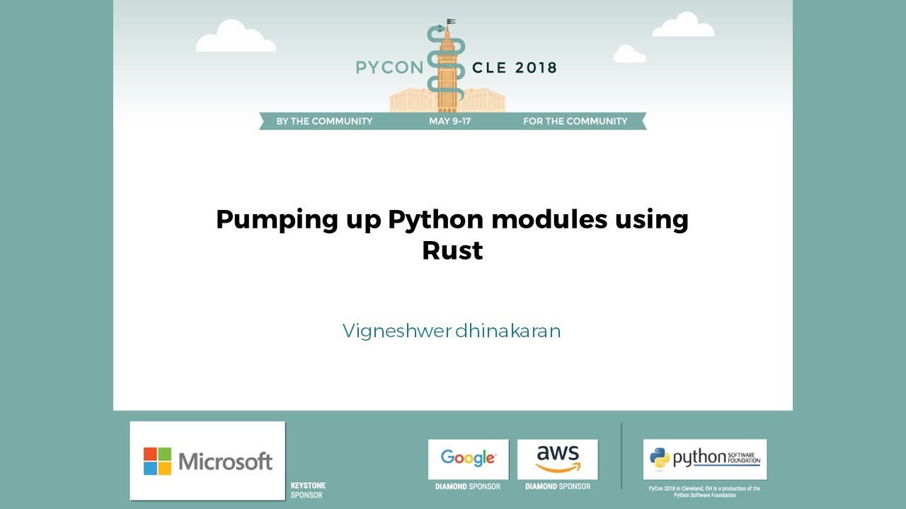

At PyCon last year, I saw an interesting talk on using Rust to extend Python:
We use some small bits and pieces of Go (mostly not written by TAs). While you could certainly use Rust to develop binary extensions for Python, Rust does have a reputation as a slow-to-develop-with language: all that memory safety comes at the cost of very slow dev cycles because the compiler is not going to let many things pass and you’ll have to work through a lot of issues one at a time to get to a working piece of software.
It’s a cool language, but personally it feels like it’s more suited to systems programming than the crazy-ass world of tools dev and support.
I think the interesting question is in the case where you have to write a python extension module, is it better to reach for C, Rust, or something like Cython?
You’re already at the point where you’re throwing out the dev speed and flexibility of python for whatever reason, so which sarlac pit of weirdness do we throw ourselves into?
