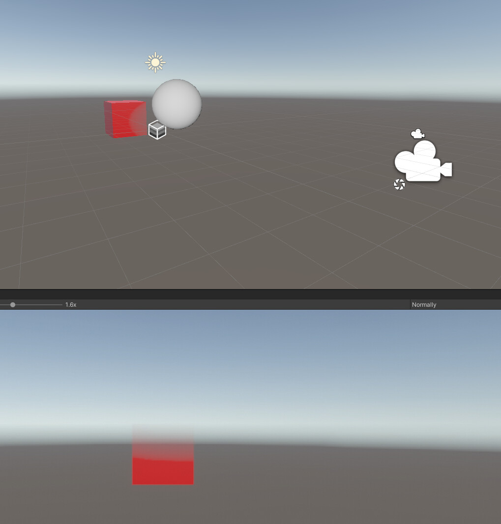

Can’t be stencil. I need alpha to change based on a black and white gradient. I think I found something in the asset store. Digging through the code now to see if I can adapt it to my needs:

An alternative in URP would be to add a second camera and have your “lens” object render only into that camera with an unlit shader that represents your gradient value (you control this with the camera’s culling mask). The second camera renders into a render texture. The main rendered object reads from that render texture to control its own alpha, using screen space coords instead of UVs
Interesting. I assume I’d still need to alter any masked shader I want to adjust though to give access to the alpha masking information.
You’d write the masked shader so it took a texture input , and then pass the render texture to the material as that texture. Since you can make the render texture as an asset on disk, you can set it as the default texture. At least if you do that in ShaderGraph shaders you can set it up so there’s no need to manually override. I think the same is possible in text shaders but I don’t recall the syntax off hand.
