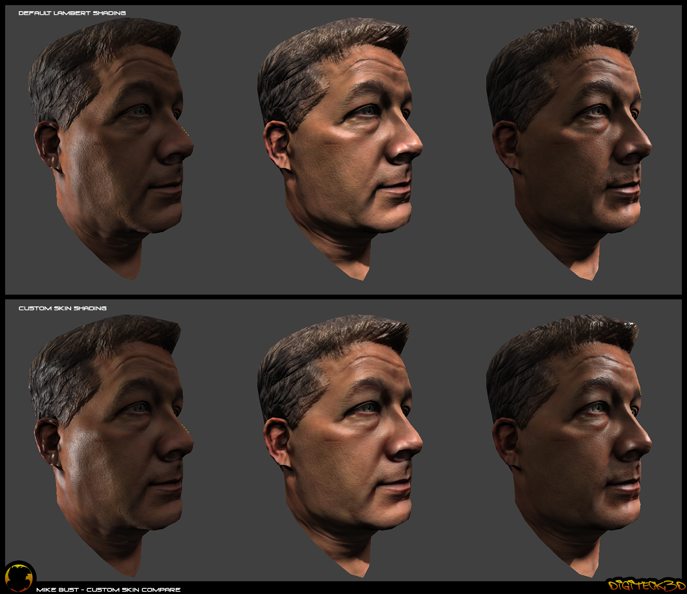

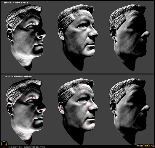

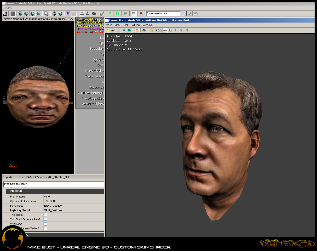

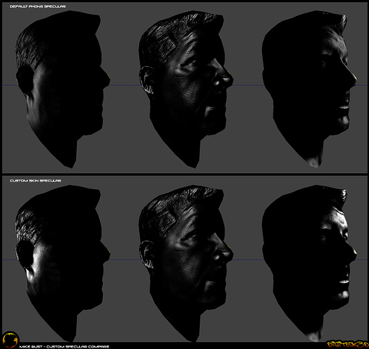

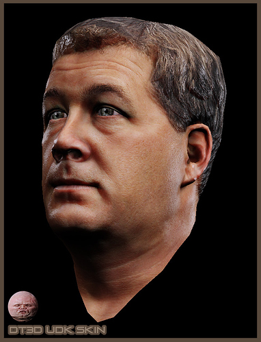

Hi, Just wanted to show you guys a skin shading system I built a while back in the Unreal Engine 3.0 based on the GPU Gems 3 - Advanced Techniques for Realistic Real-Time Skin Rendering. I implemented most of the effects described in the paper including the multilayered diffusion scattering in skin. Originally the first pass of the shader had all 3-layers as described in the paper, but with experimentation I managed to figure out that 1-layer was sufficient enough to capture the color-bleeding and surface blurring. This also allowed me to cut down code to keep the shader production friendly. Along with the subsurface I also implemented the physically based specular term to better capture the specularity of skin. Hope you guys like.
Subsurface Scattering Effect
Physically Based Specular

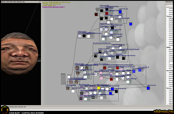

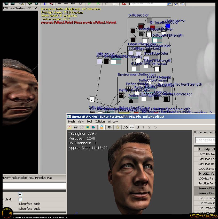

Unreal 3.0 Shading Network
Nice work, I didn’t actually know UT3 really had such flexibility, they remind me of Maya’s render nodes which I love so dearly - maybe UT3 is really all that everyone tells me it is :D:
Good work on the subsurface scattering effect too, it’s interesting to see how games do it.
thxs’ $oup! I think UT3’s material editor is amazing. It is so flexible and fun to use. You should get the UDK and give a try :):

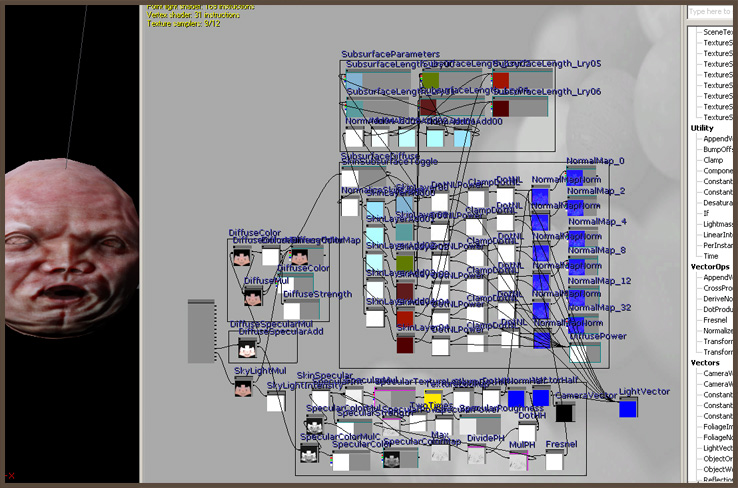

How is the performance on this? I see it has quite a few (196) instructions (not trying to break your balls, just curious because it does look nice)
:tear: Ohh Snap my balls just got broken LoL! No worries thedour, the screen I just showed is running on an old UE3 build. Even on that build we’ve had six or more characters at a time and never really dealt with any performance issues, but at work we are developing for pc platform also. In my opinion UE3’s shader system is very efficient and optimized as far as the performance I’ve seen. Epic also seems to stay on the ball by continuing this with newer builds. Because on the old build the shader registered at 196, but I’ve been working with it in the latest February Build on the UDK and now it only runs at 127. That is just from jumping to the latest build, I could still also knock out a few effects to cut it down or just replace the physically based specular term with a lesser code generic one etc… Even have the higher code for close up shots and for game play have a simpler one.
UDK February Build
Excellent, 6+ characters! That’s the kind of info I was curious about. Good work sir.
This is maybe wandering a bit OT… but I’d be careful about paying too much attention to the instruction count. While it’s useful to check if a shader is doing anything too crazy, the down side is that it’s only loosely related to actual performance. Some instructions are more costly than others in often unexpected ways, and the only way to reliably judge a shader’s performance is to use your chosen platform’s low-level profiling tools.
Also, you’re looking at the figure for static lightmapped surfaces :]. I’d guess the point light count (next one down) is what you’re after.
:nod: Nice insight Tim! I’ve always wondered about which one I should be going with, I’ve had a couple debates with our LD’s. Now finally I have the fire to win the argument. Usually my method of testing has been play testing and stat fps’s alot to make sure my shaders aren’t pushing down the performance. Would be nice to get deeper into it with low-level profiling tools.
