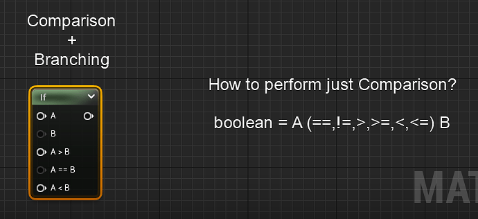

@probiner: I’m surprised there’s not a comparison node in Materials. How do you achieve it?
@archo5: should work by passing constants (0/1) to the last 3 parameters
the implementation does seems a bit unusual though

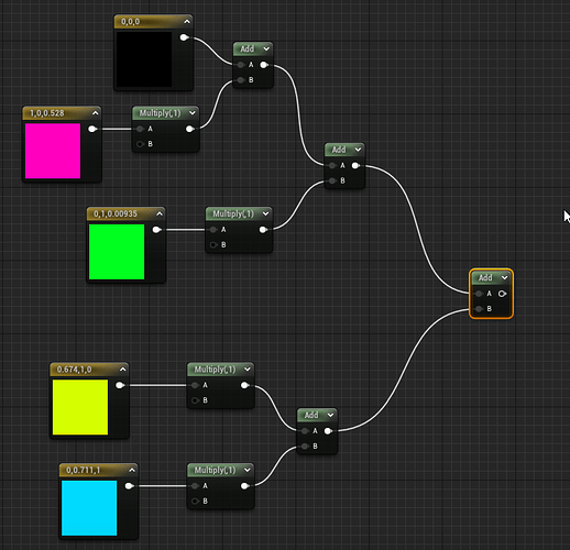

@probiner: I see, cause I was concerned about doing this.
And usually to do some branchless design one would just would do a chain or tree of Multiply-Adds.
BUT… I still need to feed the condition 0/1 to the multiply.
So you’re saying @speuzer that in this context one doesn’t need to have the same concerns as it would with CPU code?

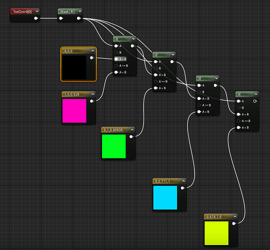

@probiner: So yeah it seems to be this @Christian , thanks. Two ternaries:
((abs({A} - {B}) > {epsilon}) ? ({A} >= {B} ? {A>B_input} : {A<B_input}) : {A==B_input}) ;
