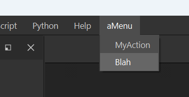

Yeah I can try. I’ll give you the code I wrote to make the following:
Also keep in mind, doing it the way I’m showing you isn’t perfect. Once you have it setup and working, with the script running, if you try to stop the script, it crashes Painter. I think Painter doesn’t actually like it when you do stuff to the Application Menu. But it works as long as you don’t try to shut the script down. Just consider your new menu item on there until you decide to remove or modify the script or something.
Here’s the code I wrote for the screenshot above:

That worked! :slightly_smiling_face:
