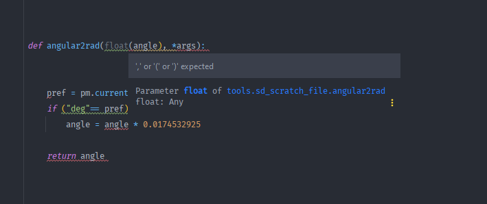

Hi, I been trying to learn pymel for maya and tool development too. so for practice I’m converting mel script to pymel. Thought this will help me understand the logic and the mathematical calculations and their syntax to implement them. I am not understanding the matrix and vector syntax in the script. I know the theory but getting stuck in syntax. Please can I get some advice and suggestions, and check where I’m making mistake.

def angular2rad(float(angle), *args):
pref = pm.currentUnit(query=True, angle=True)
if ("deg"== pref):
angle = angle * 0.0174532925
return angle

I’m using Maya 2018 and when i execute I’m just getting error. Error: line 1: SyntaxError: file line 1: invalid syntax
