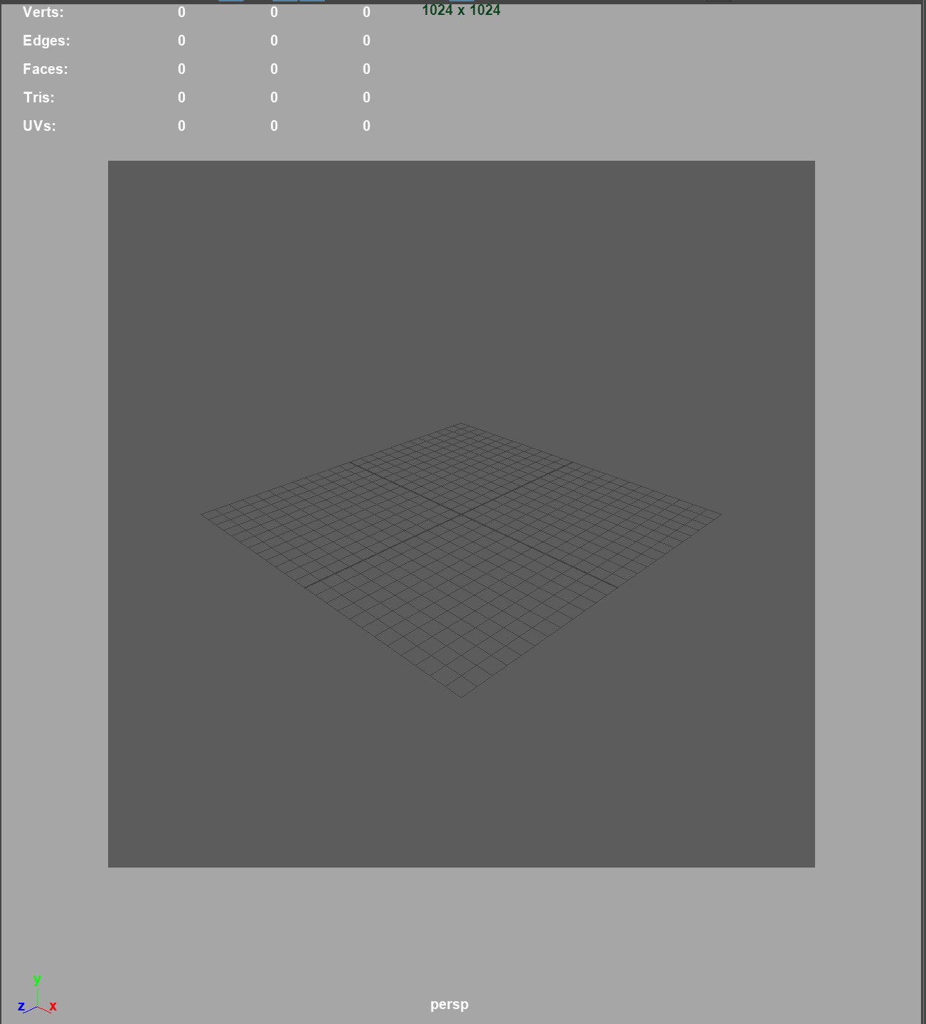

I was wondering if there was a way of getting the size of the resolution gate of the active viewport ?
I can get the size of the viewport but I could not find anything on the resolution gate.

Hello,
the code you wrote will get me the resolution in my render settings.
What I need is the resolution gate. The square in my picture. It is relative to the viewport.
I can get the size of the viewport but I can’t find the size of the resolution gate.
