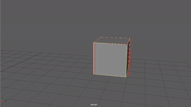

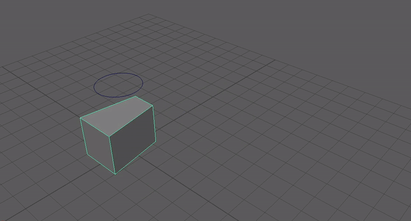

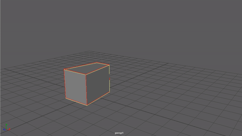

Well, I haven’t tested “automating” all this yet, but I did some tests with a cuboid.
I have a vague idea of how I could script this, but I’m not comfortable with matrices, so I have many assumptions, but practically, I don’t really know how to apply them.
So I thought the idea would be to:
Based on the controller input (the direction),
find the edge closest to the ground (if the input is → +X, retrieve all the vertices with a positive X value and then find the two with the lowest Y). Now, practically, I don’t know how I can get the coordinates of these vertices in the space of my master(red boundingBox).
Then, since we have two vectors, we can find the midpoint, but regarding orienting the yellow transform along the axis, I have a vague idea but no concrete solution.
And then, this is where it completely overwhelms me: to compensate for the movement of my yellow transform, simply reversing the values of rotation and translation isn’t enough, so I imagine it relates to the yellow pivot not being the same as the gray pivot.
And similarly, for the other steps, I have no idea how to proceed, nor even if this is a solution that works with an object that isn’t a cube, so there you go!
