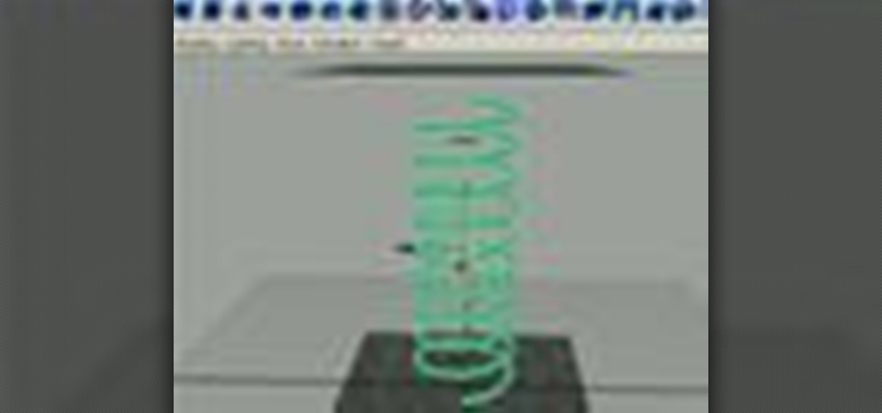

Take a look at using dynamics such as springs to give the characters “shoulderpad bones” secondary motion. Playing with dynamics requires a lot of tweaking, especially to prevent interpenetration. Be ready to noodle.
Here’s a video of spring dynamics. Google will reveal a bunch of other stuff.
