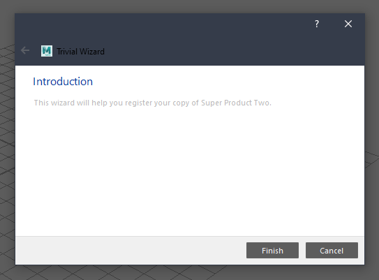

I tested QWizard in maya, and it works, however there does not seem like it has correct styling. The background is white, but text is bright grey. It looks like Autodesk simply did not bother styling it, likely because it’s not used anywhere in Maya.
So this raises a question - would it be safe to use? Or should I just go with a regular proven QWidget\Window and code my own wizard there?

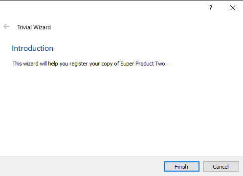

Here’s the code I tried using it with. I also tried parenting it under Maya window, and the result is exactly the same. It’s slightly adjusted code from PySide docs.

Well, just style it. WizardPage should look pretty much the same even if You run it with Python installed on Your system:
I never use Maya’s default styles. I override all of it. Maya’s styles look so 2010-ish
Well, styling is not the problem, the problem is reliability. Autodesk did cut some parts of PySide out in previous versions, so if it’s not even styled at all, just got me worried a bit. Wondered if anyone’s been using these at all in their projects.
Yes, but that’s the point, it’s not consistent. Those are likely styled just because they are styled globally. Light grey text on white background clearly means that QWizard in particular was not styled at all.
