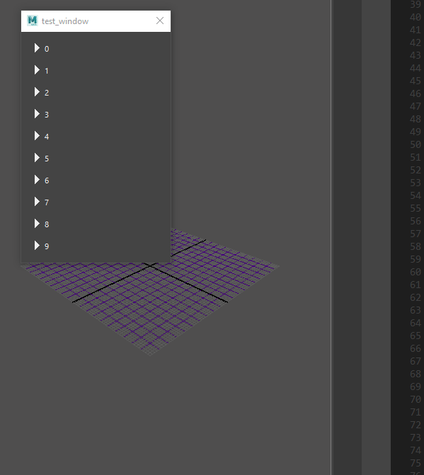

Hey there I have adapted a FlowLayout into a custom Collapsible Scroll Area and am getting a few issues (due to my lack of Qt knowledge).
I found the FlowLayout by someone else from about 7 years ago, and have just switched out the QtCore for QtWidgets where it was erroring. It seems to be working properly.
However when I put it into the custom Collapsible Scroll Area it has issues when you open one of the collapsed areas. The QVBoxLayout housing the FlowLayout does not resize to the FlowLayout vertically. However when you resize the window horizontally the layout stretches out and properly shows the FlowLayout (if they end up in a single line).
My goals here were:
- Have the layout open to the correct size depending on the amount of space the FlowLayout needs, and also to resize when you adjust the window.
- To have the collapse resize the distance between the other collapsed layouts. They seem to get really funky the more you open/close.
- Resolve the need to have the layout focused(? highlighted ? clicked twice ?) in order to collapse.
My thoughts are that the TestWindow()'s box_inner_layout is not correctly resizing? A colleague mentioned about doing a resizeEvent(?), but he doesn’t have time to look at it, as this is a personal project. I’ve never rewritten a base class function. Whoever wrote the FlowLayout knew far more than I, and was able to rewrite a few events it seems to make that part work correctly.
Any help/insight would be huuuugely appreciated!
