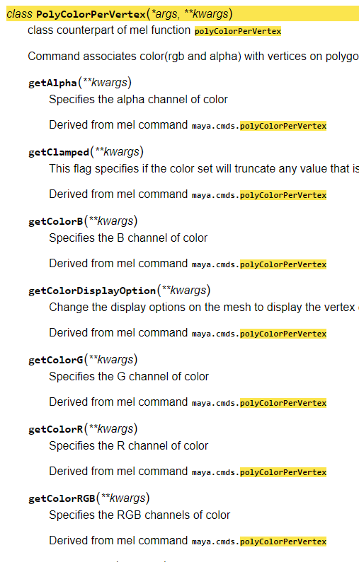

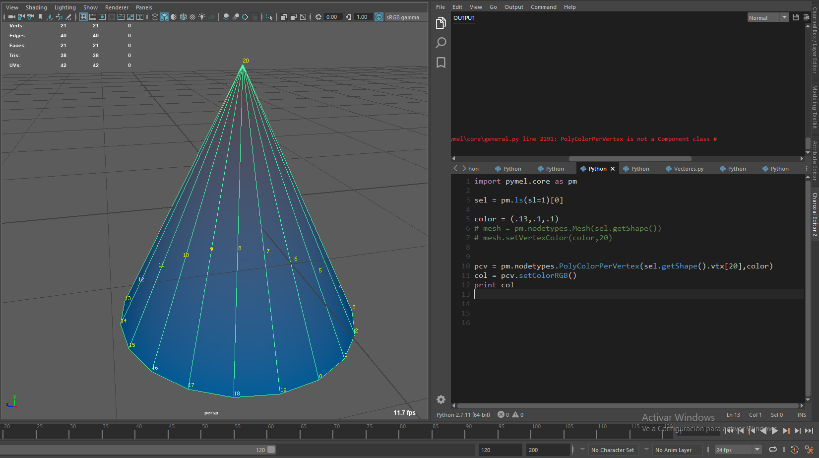

Thanks for your answer, yes, I made the wrong path, it is pymel.core.nodetypes.
JodaRobert, will you have an example to help me?
My goal is to know how to use the methods of the PolyColorPerVertex () class. Again, I know I can do it with cmds.PolyColorPerVertex (), but I want to use class methods. there are some attached.

I apologize, but your pictures aren’t loading for me. I’ll try to answer as best as I can.
pymel.core.nodetypes.PolyColorPerVertex isn’t going to help you here. It’s just not designed to be used in the way I think you’re expecting.
If you want to use a more object-oriented style of scripting, I would instead look at the pymel.core.general.MeshVertex class. You can set and query colors directly on the vertices themselves.

Thank you very much, now I understand how it works. It seems to be accessed directly from the vertices of a geometry.
I was trying to send a vertex and a color as an argument.
