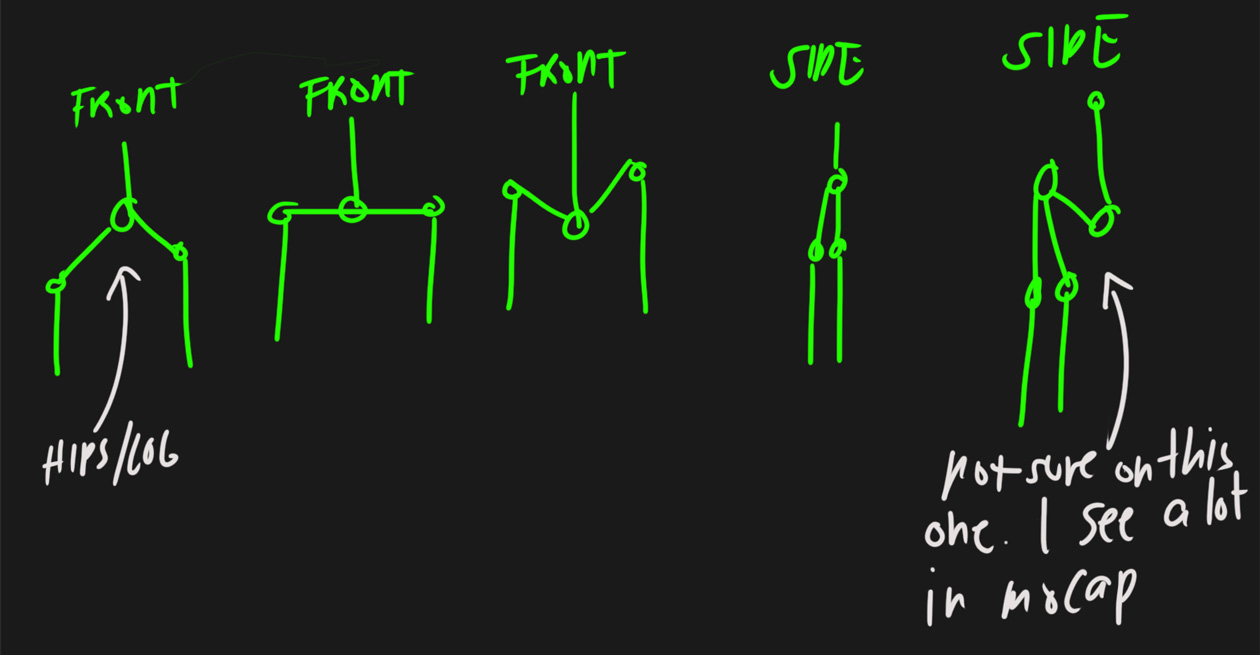

Normally, I placed the COG and hips both at the roughly same position with a small offset to avoid skin mirror weights problems.
Here is also a few images I was thinking on possible placement of Hips/Cogs in relation to the thigh joint.
Just wondering if I’m doing it right or is there a better way of doing things? What placements do you prefer?

I think usually I end up putting the leg joint a bit lower than the hips. The hip joint, I usually put right around the middle of the mass of the pelvic area. It really depends on your character too.
One thing I often do - especially for cartoony characters - is add a “hip clavicle” with a little IK chain that lets the animators move and adjust the entire angle of the hips. It is not anatomically correct, but it lets you fix a lot of extreme poses.

The “hip clavicle” is new to me. Thanks for pointing it out.
What I usually do just have direct control on the thigh_IK_joint. It does not control the angle of the thigh but only the position.
