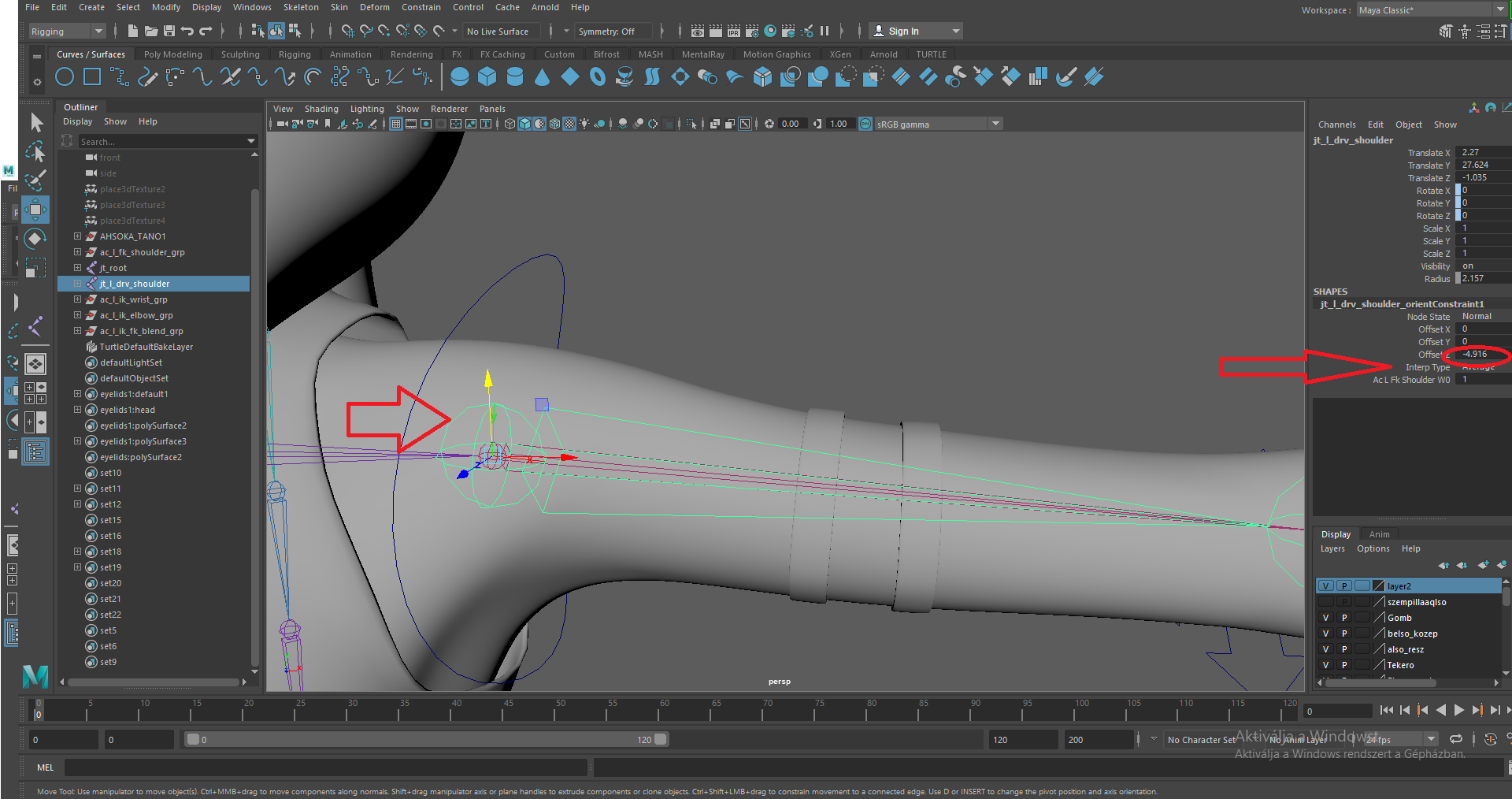

When I connect the controller curve “ac_l_fk_shoulder” and the joint “jt_l_drv_shoulder” with an orient constraint, it changes the direction of the joint. I also tried turning on “maintant offset” to keep the direction, but the joint input “offset Z” is not zero. Is this a problem or should I ignore it? In the tutorial, the guy has everything on zero at all three joints. And I can’t freeze either. I frozen the Controller before using the orient constraint.

Does the control curve have the same exact orientation as the joint you are constraining? If it does not, then that could be why you are seeing an offset when using ‘maintain offset’.
I added curve to the joint like this: first select the curve, then select the joint, then Modify / Match transformations / Match all transformations. Then I turned it.
This is what happened in the video. Still, after he used the orient constraint, Offset x, y, z and rotate x, y, z, stays 0. This link can be viewed from 7:40.
I try to upload a screenshot of my project, and hope you can see what I am talking about.
In the video you provided, it looks like he has his control curves parented under groups. You may want to try matching the group transforms to the joint transforms instead of matching the control curves to the joints, and then zero out the rotations on the control curves. The groups above each control do not need to be frozen after matching transforms. They act as an orientation buffer or holder for the control curve.
Thank you so much, this was the solution you wrote. It works.
