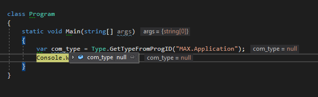

I encountered this problem, but even debugging the solution I cannot find what is causing it.
Unhandled Exception: System.Runtime.InteropServices.COMException: Retrieving the COM class factory for component with CLSID {7FA22CB1-D26F-11D0-B260-00A0240CEEA3} failed due to the following error: 80040154 Class not registered (Exception from HRESULT: 0x80040154 (REGDB_E_CLASSNOTREG)).

I tested this on 3 machine, my laptop , my work pc and my own pc
For the first two everything worked perfectly
On my pc I have this problem.
So I reinstalled the mxspycom , the release one, this time and I removed manually the class register in the registry file.
Now opening max the registry is written again but executing the script I still have this problem
What I am missing?
