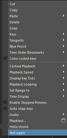

So using that name we can modify the menu, e.g.
cmds.setParent("TimeSlider|MainTimeSliderLayout|TimeSliderMenu", menu=True)
cmds.menuItem(label="Hello World")
Or:
parent = "TimeSlider|MainTimeSliderLayout|TimeSliderMenu"
cmds.menuItem(label="Not again", parent=parent)
Making:
