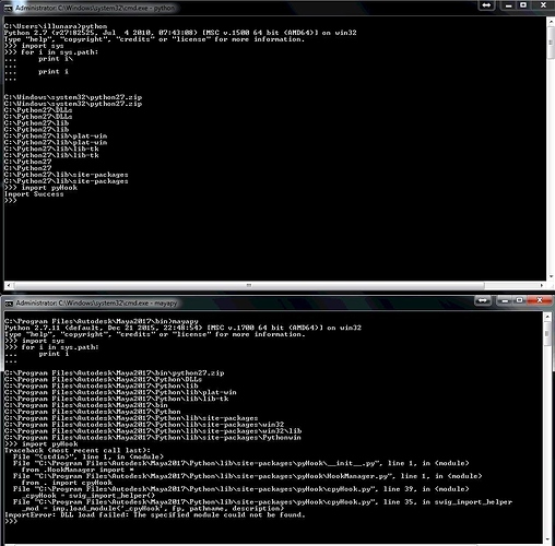

Mayapy DLL Missing when loading module
Hi everybody
Here is some informations
Python 2.7, x64, pyHook-1.5.1-cp27-cp27m-win_amd64.whl setup using pip
And here is the result
Full code

And this is where the error occurred
_mod = imp.load_module(‘_cpyHook’, fp, pathname, description)
This is very strange because in the line before
fp, pathname, description = imp.find_module(‘_cpyHook’, [dirname(file)])
it still recognize the module
Why did this happened? Why mayapy can’t import the module the same way python standalone can? It has the same core is python 27, right?
