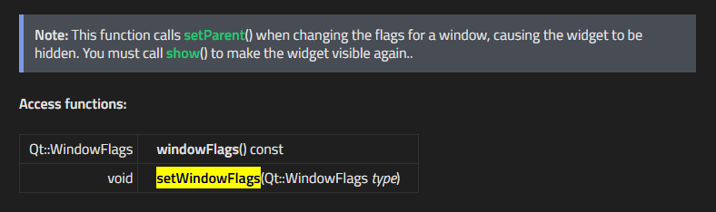

And you were right about setWindowFlags() calling setParent(). This is from the Qt docs
So it appears that the only option is to do this, and live with the flicker…
