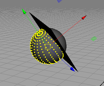

If you run this on a sphere you get something like this.
The plane in the picture is where the pivot point is.
mirror_verts
