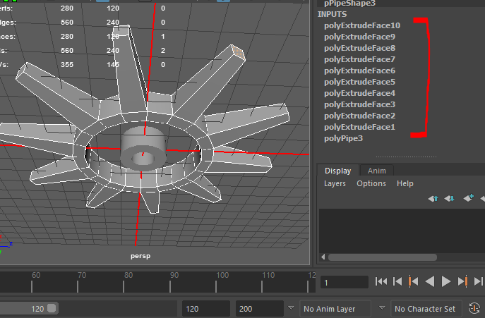

Hi guys, I am trying to execute a cmds.polyExtrudeFacet() command on some faces, but the command just accept the format object.f[start:end] without allowing me using a step parameter.
I would like to avoid maya API and know if there is a way to make this.
Another solution I found is to extrude every face in a loop, but this lead me to a separate construction history per face, and that’s not so cool.
Thanks :slight_smile:

Solved it, I didn’t know that using cmds.polyExtrudeFacet() without faces parameters uses the faces in selection!
So with pymel, you can actually pass a tuple to the objects component iterator.
import pymel.core as pm
obj = pm.polySphere()[0]
pm.polyExtrude(obj.f[1,3,5,7,9,11, 13:25], ltz=5)
with cmds, you’d need to pass a string for each separate face or group of faces.
from maya import cmds
obj = cmds.polySphere()[0]
cmds.polyExtrudeFacet(obj + '.f[1]', obj + '.f[13:25]', ltz=5)
Both of these will create just one single extrude node in the history.
