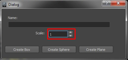

Hi, is there a way of creating a spinbox without using QT?
I don’t believe so. All the built int stuff seems to favor sliders over spin boxes.
Easier way to add it using QT? I mean without knowing API , OOP and other stuff?
Probably the absolute simplest would be generating your UI in the designer and then loading it with cmds.loadUI. As it can be a little tricky to parent QWidgets under random maya controls.
Don’t think there is. However if you set the -step flag on an intfield, the user can middle-drag in that field to increment or decrement the value by the step you set

@Theodox, yeah, thanks for the tip. At least this is much better than typing in.
