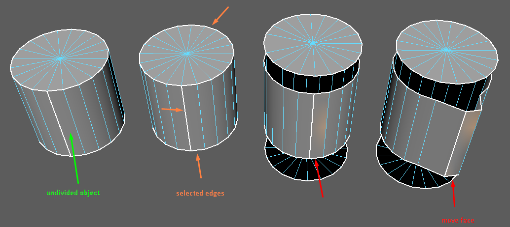

if I have geometry something like that, cylinder, I detaching geometry by edges, and red edge remains un-cut on mesh and cut on UV. That would not be a problem if I didn’t need to use a cleanup to fix mesh errors and detached polygons to solve problem.
I can’t found solution, or scripts… It’s simple command in Max - split… but in Maya for me it is unreal problem.
*I used DetachComponent;
small GIF presents result, Pinned vertexes have small padding to near UV shell:
You need to do the detach on the vertices not the edge.
baaad idea :roll_eyes: the entire perimeter of geometry will turn into separate polygons
You want to convert the edge that you’re operating on to vertices, and then detach just those vertices that make up the edge you are operating on.
polyListComponentConversion is helpful for this kind of thing.

Result each time ± the same:
And I solved the problem. Result:
This situation with this mesh’s form is an exception, but this form exists so problem exists too.
