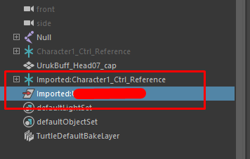

But this still leaves behind dag objects in the scene:
