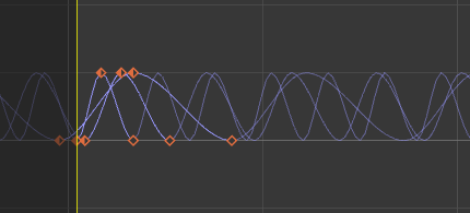

Here is a quick example. I put 1 bulge blendshape on a lattice.
Then 3 more random noise blendshapes, which are animated randomly. Or rig a few controls.
Then move that lattice along your geo. You have to move the lattice and baseLattice at the same time, otherwise, it will move the geometry, instead of sliding.
