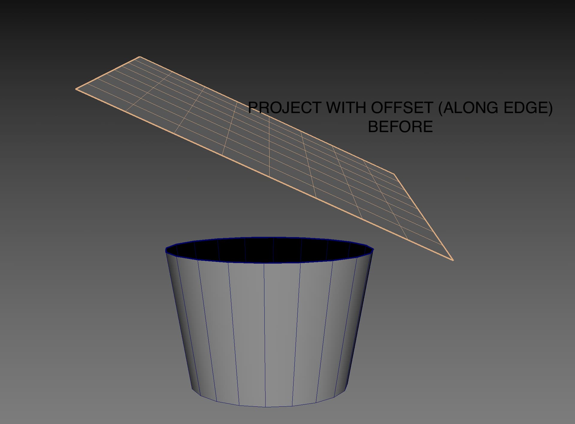

thanks for the information, I am trying to make a tool to project( extend) edge to a plane,
I was thinking of maybe creating a curve and scaling it so it intersects with the target mesh then finding out the intersection point.
Currently looking into using closestIntersection, but I am still learning API.

You could greatly optimize your code for a closestIntersection function or the like.
But, specifically for this case, it would be excessive and redundant.
This case is the most trivial: “the intersection of a line and a plane”.
It is detailed in the Maya Python API 2 examples:
https://help.autodesk.com/view/MAYAUL/2023/ENU/?guid=Maya_SDK_py_ref_python_2api2_2py2_square_scale_manip_context_8py_example_html
And again, it is not clear why you need to do this exactly (unless, of course, this is an arbitrary example for pumping programming skills).
Perhaps, if the ultimate goal were known, the problem could be reformulated to find the optimal method for solving the problem.
Also, if you intend to use the Maya Python API, it makes sense to use the new Python API 2.
Yes, many things are documented ugly and with errors, but it’s worth it to be persistent and make an effort. ![]()
Good luck and harmony!

if denominator > .00001: intersection = ray_position + ray_direct * denominator / ratio
else: print("Ray direction and plane - parallel !")
# Result: maya.api.OpenMaya.MPoint(13.961696399865353158, 48.060789174806089363, -10.143764332457209321, 1)
## Let's check the result.
## move our vertex responsible for "dir_position" (in_point_02 "sourse_poly_000.vtx[10]")
## to the position of the intersection point:
fn_mesh_cyl.setPoint(10, intersection, 4)
## setPoint(10, intersection, 4).
## "10" - verttex ID from "target_poly_000.vtx[10]"
## "intersection" - target position (OpenMaya.MPoint):
## (13.961696399865353158, 48.060789174806089363, -10.143764332457209321, 1)
## "4" - World Space in MSpace: "om.MSpace.kWorld" or "4" (om.MSpace.kWorld == 4)
## Or, for clarity, let's create a locator at the position of the intersection point:
sp_locator = cmds.spaceLocator(p=(intersection.x, intersection.y, intersection.z), n="Intersection_000", a=1)
om.MGlobal.clearSelectionList()
cmds.setAttr("{}.localScale".format(sp_locator[0]), 2.0,2.0,2.0, type="double3")
cmds.setAttr("{}Shape.overrideEnabled".format(sp_locator[0]), True)
cmds.setAttr("{}Shape.overrideColor".format(sp_locator[0]), 9)
We have verified that this method works.
Yes, but how much more efficient and reliable is this method than the universal “closestIntersection” (without activation of acceleration methods)?
First, we modernize the code to automate the process (for a cylinder with an arbitrary number of edges-rays)
Let’s include two functions for finding intersections in the code.
Let’s provide an opportunity to switch between methods.
The first one will use the “closestIntersection” method (without activating the acceleration methods).
The second will use the classical mathematical method.
import maya.cmds as cmds
import maya.api.OpenMaya as om
try: from time import perf_counter as t_clock
except ImportError: from time import clock as t_clock
from timeit import timeit
maya_useNewAPI = True
def create_cilynder(ray_count):
poly_cyl = (cmds.polyCylinder(name="sourse_poly_000", r=10, h=20, sa=ray_count, sh=1, sc=0, ax=(0, 1, 0), rcp=0, cuv=3, ch=0))[0]
cmds.delete( "{}.f[{}:{}]".format(poly_cyl,ray_count, ray_count + 1) )
cmds.move(0.0, 10.0, 0.0, poly_cyl, r=1)
cmds.scale(1.25, 1.0 ,1.25, "{}.e[{}:{}]".format(poly_cyl,ray_count,ray_count*2-1))
return poly_cyl
def create_poly_plane(height, weight, division, translation, rotatation):
poly_plane = (cmds.polyPlane(name="target_poly_000", h=height, w=weight, sh=division, sw=division, ax=(0, 1, 0), cuv=1, ch=0))[0]
cmds.move(translation[0], translation[1], translation[2], poly_plane, r=1)
cmds.rotate(rotatation[0], rotatation[1], rotatation[2], poly_plane, r=1)
return poly_plane
def fn_mesh(name):
sel_list = om.MSelectionList()
sel_list.add(name)
dag_path = sel_list.getDagPath(0)
fn_mesh = om.MFnMesh(dag_path)
return fn_mesh
def create_ray_dir_array(poly_cyl, ray_count):
sel_list.add("{}.e[{}:{}]".format(poly_cyl, ray_count*2, ray_count*3-1))
node, component = sel_list.getComponent(0)
it = om.MItMeshEdge(node, component)
edges_count_in = it.count()
ray_float_point_array = om.MFloatPointArray()
dir_float_vector_array = om.MFloatVectorArray()
while not it.isDone():
point_0 = om.MFloatPoint(it.point(0))
point_1 = om.MFloatPoint(it.point(1))
ray_float_point_array.append(point_0)
vector_d = om.MFloatVector(point_1 - point_0).normalize()
dir_float_vector_array.append(vector_d)
it.next()
return ray_float_point_array, dir_float_vector_array
def intersections(poly_cyl, ray_count):
time_00 = t_clock()
fn_mesh_target = fn_mesh(poly_plane)
arrays = create_ray_dir_array(poly_cyl, ray_count)
ray_float_point_array = arrays[0]
dir_float_vector_array = arrays[1]
k_space = om.MSpace.kWorld
testBothDirections = False
k_tolerance = 0.001
maxParam = 100.0 # As the maximum possible value of this parameter,
# it would be correct to pre-calculate the diagonal of the overall boundingbox.
# But we will set just a reasonable value with a little "margin"
gen_list_inter = om.MPointArray()
for i in range (ray_count):
raySource = ray_float_point_array[i] # start point for ray search intersects. current edge(0)
rayDir = dir_float_vector_array[i] # calculate direction for search intersects. Vector from current edge(0) to current edge(1)
hit = fn_mesh_target.closestIntersection( raySource,
rayDir,
k_space,
maxParam,
testBothDirections,
#faceIds, triIds, idsSorted, accelParams,
# If you do not use these parameters,
# then simply do not specify them.
# You do not need to specify the value "None" !!!
# Otherwise it will cause errors or Maya crash.
tolerance = k_tolerance
if hit and hit[0]: # if no hits, in Maya <=2020: return [], Maya>2020: return None
hit_point, hit_ray_param, hit_face, hit_triangle, hit_bary_1, hit_bary_2 = hit
gen_list_inter.append(hit_point)
time_00 = t_clock() - time_00
print("\n\t\t Total search intersects time for {} rays: {} s. (\"closestIntersection\" metod)\n".format(ray_count,time_00))
return gen_list_inter
def target_const(poly_plane):
fn_mesh_plane = fn_mesh(poly_plane)
N = om.MFloatVector(fn_mesh_plane.getPolygonNormal(0, om.MSpace.kWorld).normalize())
plane_point = "{}.vtx[0]".format(poly_plane)
plane_point_position = om.MFloatPoint(fn_mesh_plane.getPoint(0, 4))
return N, plane_point_position
def intersections_simply(poly_cyl, poly_plane, ray_count):
time_00 = t_clock()
N, plane_point_position = target_const(poly_plane)
ray_direct = dir_float_vector_array[i]
ray_position = ray_float_point_array[i]
ratio = N * ray_direct
denominator = N * om.MFloatVector( plane_point_position - ray_position )
else: cmds.error("Ray direction and plane - parallel !")
gen_list_inter.append(intersection)
print("\n\t\t Total search intersects time for {} rays: {} s. (\"Math Intersection\" metod)\n".format(ray_count,time_00))
def move_vertices(gen_list_inter, ray_count, poly_cyl):
if len(gen_list_inter) == ray_count:
fn_mesh_cyl=fn_mesh(poly_cyl)
for i in range(ray_count):
fn_mesh_cyl.setPoint(ray_count + i, gen_list_inter[i], 4)
def locators_for_intersects(gen_list_inter, ray_count):
for item in gen_list_inter:
sp_locator = cmds.spaceLocator(p=(item.x, item.y, item.z), n="Intersection_000", a=1)
def general(ray_count, method=1):
poly_cyl = create_cilynder(ray_count)
poly_plane = create_poly_plane(50.0, 50.0, 10, (0.0,40.0,0.0), (0.0,0.0,30.0))
if method !=0:
gen_list_inter = intersections_simply(poly_cyl, poly_plane, ray_count)
else:
gen_list_inter = intersections(poly_cyl, ray_count)
general(50) ## "Math Intersection" metod. Or "general(50, 0)" - "closestIntersection" metod
## !!! Maya does not allow you to create a cylinder with more than 1000 divisions !!!
For 1000 intersections, without data preparation
(Time spent only on calculation of intersection. Without data preparation ):
general(1000, 0)
# Total search intersects time for 1000 rays: 0.0131282000002102 s. ("closestIntersection" metod)
general(1000)
# Total search intersects time for 1000 rays: 0.0029899000001024 s. ("Math Intersection" metod)
“Math Intersection” metod ~ 4.5 times faster
For 5,000,000 intersections, including data preparation overhead:
ray_count = 1000
timeit(lambda: intersections(poly_cyl, ray_count), number = 5000)
# Result: 88.27569920000133 s. ("closestIntersection" metod)
timeit(lambda: intersections_simply(poly_cyl, ray_count), number = 5000)
# Result: 37.94165220000105 s. ("Math Intersection" metod)
“Math Intersection” metod ~ 2.5 times faster
Obviously, the mathematical method does not look for intersections within the boundaries of our plane.
Intersections are searched for an arbitrary infinite plane drawn through the specified point and oriented according to the specified normal.
This quality may be indispensable in some cases, but may be a hindrance in others.
