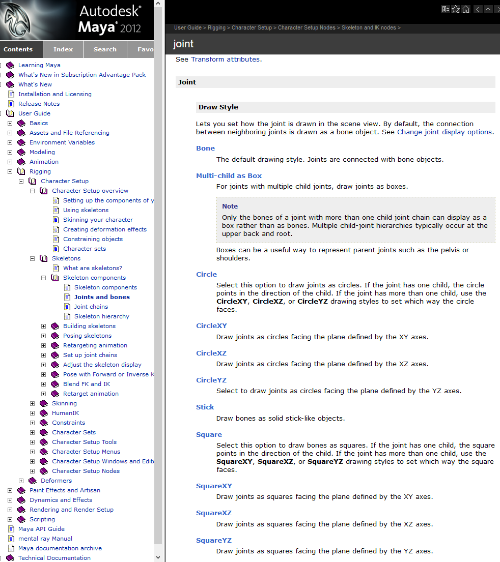

you can change the draw style of joints to display as the bone structure you see now, if you have multiple children you can display it as a box which uses the orientation of the joint. or you can set it to none to not draw the bone and visualization between children.
there used to be a lot more options on draw styles back in Maya 2012, but they where removed since 2013
