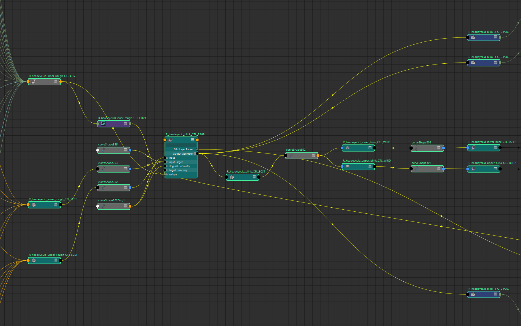

First, these are the nodes I’m looking at (this is a rig for some eyelids, it’s a little complicated so it would be a lot to show everything)(and I apologize for some of the rough naming):

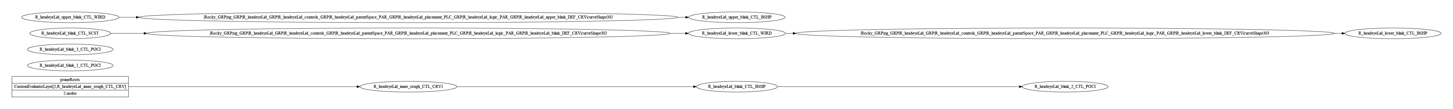

and this is the output of the scheduling graph tool:
My question is: does this imply that the separate “rows” of nodes are evaluated concurrently? As in it would try to evaluate “R_headeyeLid_blink_3_CTL_POCI” at the same time as “R_headeyeLid_blink_1_CTL_POCI”? (I’m running this in serial mode but let’s pretend)

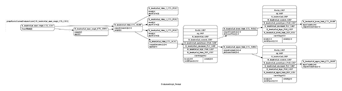

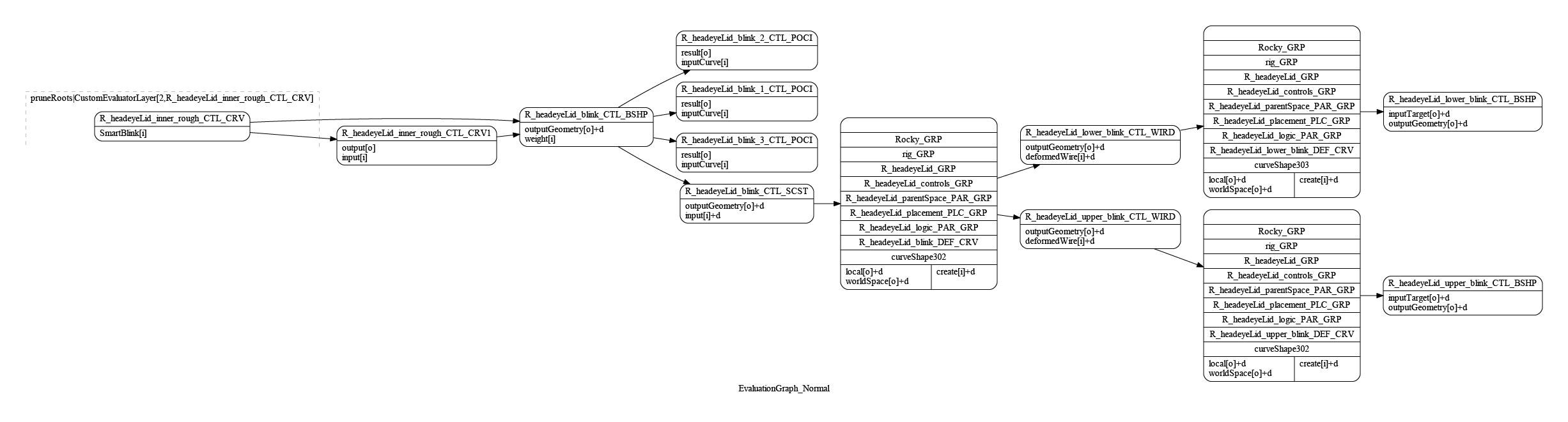

This is the output of the evaluation graph visualizer for the selected nodes:
From my understanding, the Evaluation Manager generates a new evaluation graph whenever some specific changes happen to the scene, including when a new node gets it’s attributes keyed in the timeline. In this scene, the only change I’ve made since it’s been opened has been to add two keys to an attribute on “R_headeyelid_inner_rough_CTL_CRV”. My assumption is that this would trigger the EM to rebuild the EG, starting from the newly dirty keyed attribute. However, looking at the graph above, it looks like only some of the downstream attributes from the keyed “smartBlink” attr have been marked dirty, and not all of the ones I’d expect. Would there be some caching going on or something?
It’s probably difficult to have an exact answer with only a subset of the graph, and I apologize, but I wanted to keep things legible. I guess my question is would anyone know why only a subset of the attributes downstream of a changing attr might be marked dirty.

Okay, so for the first question I had, it turns out that (when in serial mode, at least) the “rows” of nodes sequences are evaluated serially, but are not directly connected one after another and have a large number of intermediate nodes scheduled between them. It appears that they are ordered earliest to latest from bottom to top, so the bottom row would run, then eventually the row above that, then eventually the one above that, and so on.
