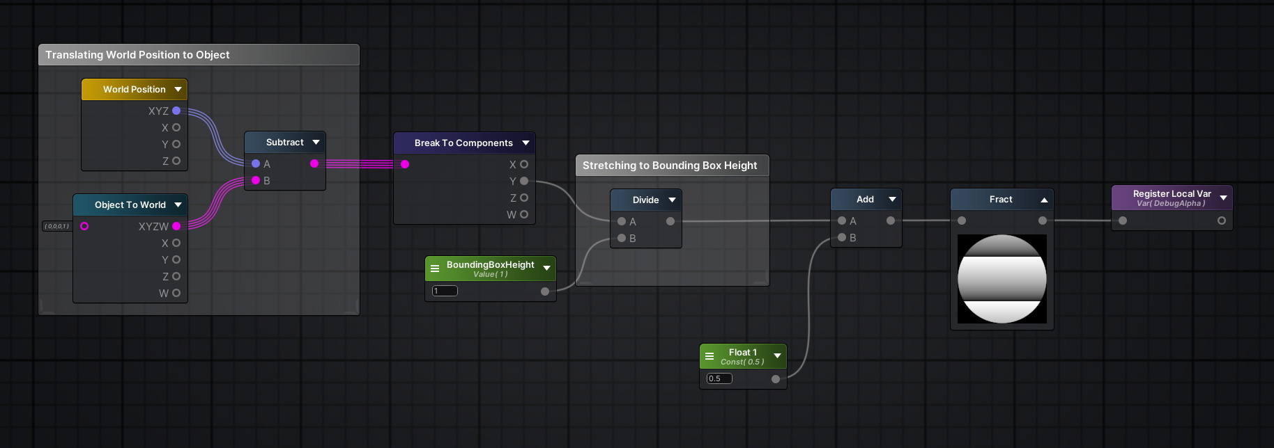

Here’s my node setup:
Now, the BoundingBoxHeight variable is fed via script in which I calculate the height of the mesh. The script looks as follows:

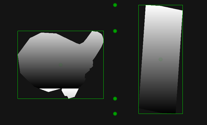

Here’s what it looks like in the scene:
[I wanted to post a screenshot right here, but new users are not allowed to include more than one screenshot, so I will put in a reply I guess]
So, as you can see it works for scaled and rotated boxes for example, but the gradient is starting to repeat on the suzanne mesh. This only occurs when the model is rotated a certain way, but I might not be able to see the right values in other rotations since the values might just be slightly off and it only becomes more visible in other rotations.
I don’t understand why it’s not working for the custom mesh since the gizmos show that the height is calculated correctly? I don’t understand why it’s only working for primitive shapes.
