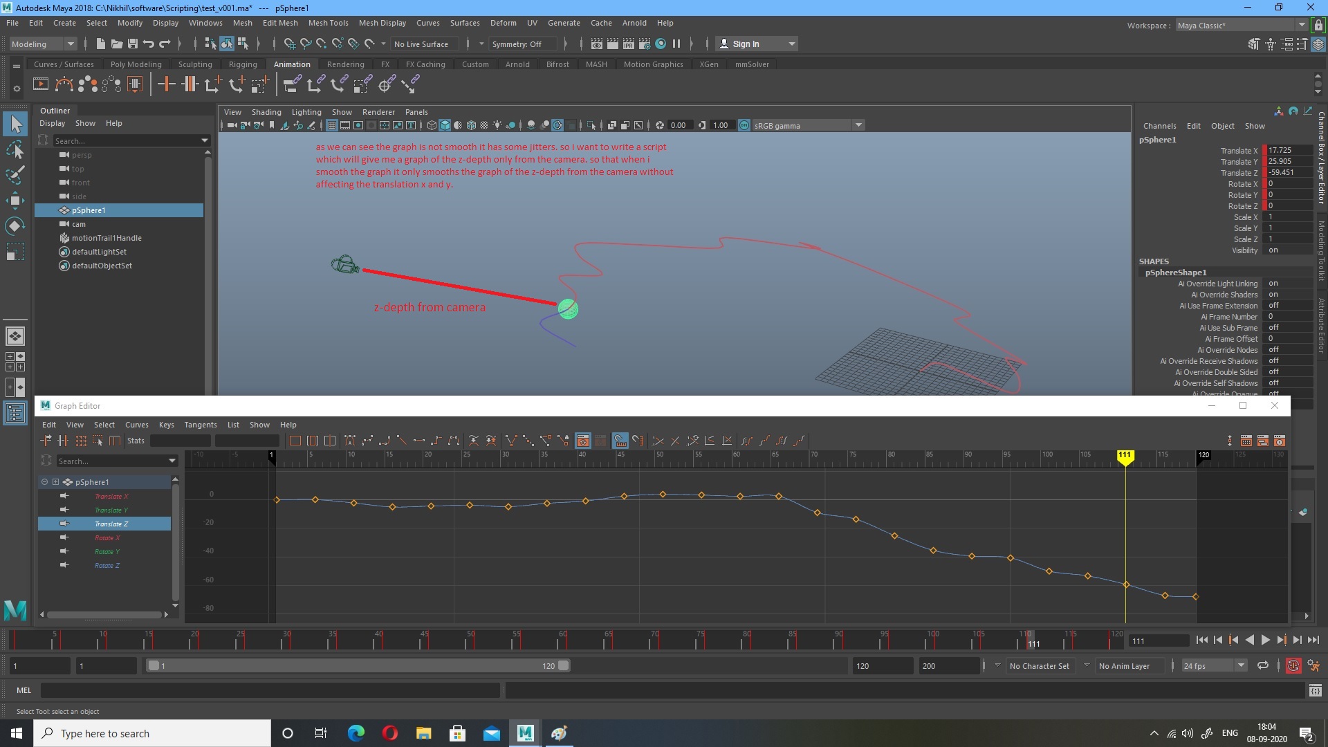

How do I get the object space with respect to camera so that the translation z displays depth with respect to the camera.
I think this is what I’d do
- Parent constrain a locator to the camera
- Add an aim constraint to the locator, pointing Z at your object
- Make a second locator, child of the first.
- Parent Constrain that locator to your object.
- Bake the motion of the second locator, and delete the constraint.
- Bake the motion of the first locator, and delete the constraint.
- Filter the z-depth curves on your second locator
Then you can just constrain back to that second locator, and bake the motion when you’re done.
Hey thanks,
But as u suggested if i parent constraint the first loactor to the camera then we cannot add the aim constraint to the same locator as the rotation axis is also connected. Is it ok if i use the point constraint on the locator and then aim constraint.?
Yeah, do the thing that works.

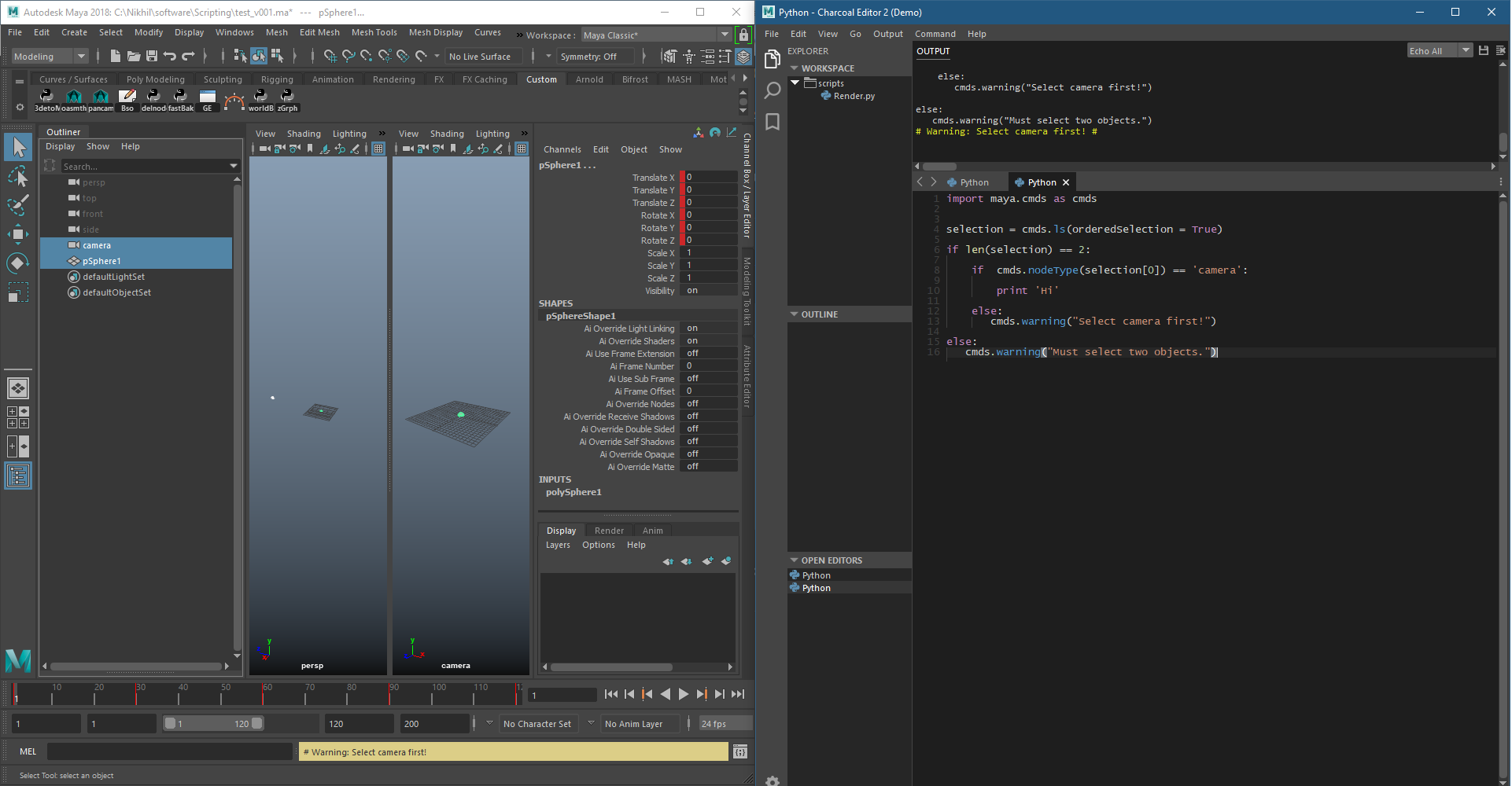

Hey,
to select the camera and object i have used ls orderedselection option, so how can i check whether the first selection is a camera.? else to display error saying first select camera then object .?
allobj = []
allobj = cmds.ls(orderedSelection = True)
for obj in allobj :
if cmds.nodeType(obj[0]) == ‘camera’:
print obj
else :
print "select camera first then object"
I don’t have access to maya right now to check, but that’s definitely the structure of how to do it.

Hey i tried it out but it is giving an error.
Error: No object matches name: c
Traceback (most recent call last):
File “”, line 12, in
RuntimeError: No object matches name: c
and sometimes :
Error: No object matches name: p
RuntimeError: No object matches name: p
the file contains a camera named cam and pSphere so with this script it is comparing the first letter that is c or p depending on the first selection, if in the nodeType(obj[0]) i write only nodeType(obj) then either i select camera or other object it displays the same else statement.
if cmds.nodeType(obj[0]) == 'camera':
should be
if cmds.nodeType(obj) == 'camera':
yes i tried this too if i use only obj then i should the camera name for print obj. But it is still printing
select camera first then object, even if i select camera first
You testing the condition on every object - i’m assuming you want to check the selection length and then the type of the first object being a camera.
selection = cmds.ls(orderedSelection = True)
if len(selection) == 2:
if cmds.nodeType(selection[0]) == 'camera':
# Your code...
else:
cmds.warning("Select camera first!")
else:
cmds.warning("Must select two objects.")
