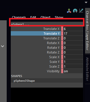

Hi, I’m looking for a way to create a UI that can be added to Maya’s native UI. Currently I haven’t found a way to do it.
Does anyone know how to do it?
I want to add a few tool buttons in the red position
And here, I want to create a UI that can be dragged and snapped into the Maya UI like this.
Thank you very much .__.
both of these are different in functions:
this is modifying an existing maya widget:
you will need to find the correct widget name (hope that its consistant) and insert elements through cmds, or wrap its instance to a qt object and insert data with pyside, this can be quite tricky to keep consistant, especially if you want maya to startup with this by default
this is called dockwidgets, this can be achieved with both cmds and pyside, for pyside there are a couple of methods but the easiest would be to use the MayaQWidgetDockableMixin to get the general setup that maya uses by default, the cmds method uses dockcontrol

For the second example, I wouldn’t use neither the MayaQWidgetDockableMixin nor the dockControl command, as they won’t allow you to dock your windows everywhere, but only “top”, “left”, “right” and “bottom”. You want to use a workspaceControl command, as that will allow free docking everywhere and can preserve window position and docking when Maya shuts down!
