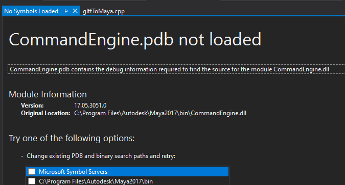

Here is a current example.
I recently renamed a some source files and functions, now I’m trying o debug my project , which compiles just fine, but on attaching and debugging, generates a Mel Script error in the script editor. setting a break point and running the debugger gives me this.
CommandEngine.pdb does not exist on my machine, and from the Autodesk forums It appears it is not supposed to be there. So, why on earth is Visual studio complaining about it? How can I tell VS to stop looking for it? Or Is the Autodesk forum post in error? How am I supposed to know?
Autodesk does not release the CommandEngine.pdb files (or any of its own .pdbs)
I googled that I could set VS to disassemble machine code instead. doing so, I noticed that in the call stack was a lot of Python27.dll. I thought “Why is python being invoked?” Then I thought “Maybe the gltf JSON is involved.”
I checked the gltf json data and it was pointing to a .bin resource that did not exist. ( Python27.dll probably has nothing to do with it: those stack calls were likely my own testing UI)
Well that was a case of “the problem you see is not the problem you have”.
Coming from Python I would expect some kind of “your data is bad” error, but I guess in compiled C++ land you have to code your own such things.
