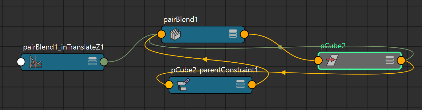

Getting affected plug from selected animation curve
If I select only the animation curve pairBlend1_inTranslateZ1, is there a way to get the plug on pCube2 that is affected by this animation curve?
I tried using recursion with MPlug::destinations(), but it always returns the wrong plug on pCube2.
