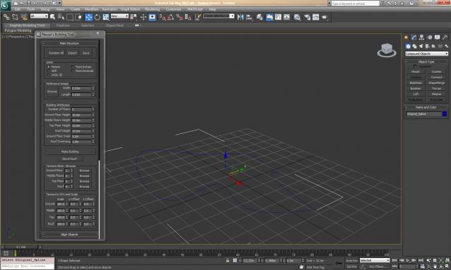

Hey guys, I hope you can spare some time to try out my script. It’s a procedural building generator designed to make buildings suitable for game environments.
You can download the script HERE

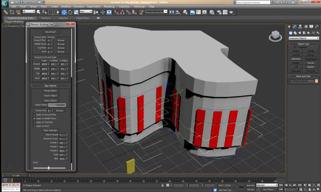

Version: 1.07 -Added a (finally) functioning controller to adjust the vertical positioning of aligned assets, and I also made the tool work on any Max version 2010, 2011, or 2012!
Version 1.08
Middle floors can now be either one single piece of geometry or each middle floor can be it’s own piece of geometry. You get to decide.

Okay - first - part of my thesis is the UI so I don’t want to show the details on how to use it. It is supposed to be very intuitive and I hope many of you would try it out and rate how easy it was to use as well as how useful a tool it can be in your workflow.

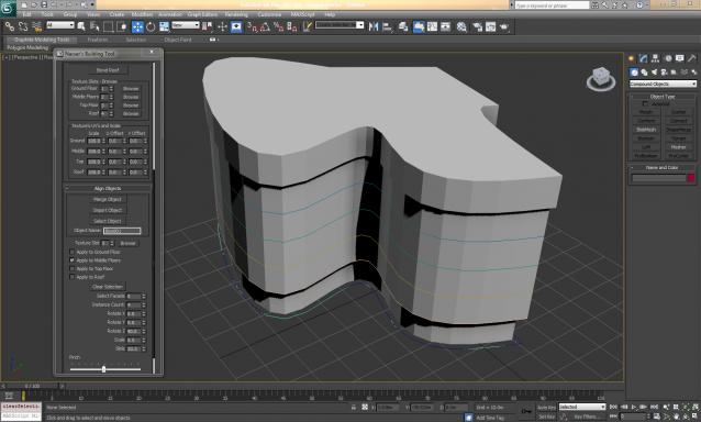

One question for you guys - The way I have this now all the middle floors ( floors 2-9 in a 10 story building for example) is separate geometry for each individual floor. This is good if you want to do major changes to those floors - but bad in that it slows everything down. How useful or detrimental would it be if I made all those floors one piece of geometry? You would still be able to align stuff to it as if it were many, but you would lose the freedom of having each one floor be it’s own thing.
Of course the quick answer is to do them both and give the user an option… but as for usefulness… would you need those middle floors to be seperate?

Version 1.08
