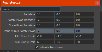

Hi there,
I am building a tool for popping up attributes on the selected node. I could use some help with the filtering - there are so many types, compounds, arrays compounds of arrays etc. In the image below - I want to gather the simple compounds like translate, which is working fine on a transform node, however if on a shape node, all the complex attributes are messing things up, I am trying to filter them out in a way that is automatic, rather than having to specify an ignore list.
I am finding it difficult to understand the complexity of the multi, array, compounds and how to filter them. Are there any good articles on the web to improve my knowledge. I have been looking at Maya native scripts for Channel Control etc to help. I am using methods like ignoring ‘.’ and ‘[’ in the attribute names but it keeps tripping up as I try it on different nodes.
I suppose pointing to learning material on attributes would be the best help? So I can do a bit of research and come back to this and make the tool more robust.

The attrs you are displaying look like double3 and float3 attribute types to me.
I’d build a list of attribute types to include. You can expand as you solve displaying new types.
and use attributeQuery with the a -type flag to skip ones you have not yet solved the display for. the attribute types are documented under addattr
I’d also probably do this in python / maya.cmds
Thanks for that.
I have had good success with this, skipping translate’X’ and rotate’Y’ etc.
Also quick filters to ignore by name. On pop up I am just listing what is in the channel box before I do a search. Hence the individual channels are listed first.
I’m not sure what exactly I want to show yet so this is working snappy enough for me. I know I’ll encounter issues down the line but will take it as it comes as I am just building for me.
Thanks for the pointers.
