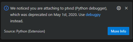

I’m having an issue trying to set up vs code for maya, it says I’m using ptvsd for debugging, but I cannot figure out how to switch to debugpy
I tried to use ptvsd in maya, and the first time I run a script it works, but subsequent attempts fail

I have followed the post https://www.aleksandarkocic.com/2020/12/25/debugging-in-maya-with-debugpy-and-vscode/ , I downloaded debugpy, placed it in a PATH folder for maya, and the code runs with no errors
this gives me that issue in vs code where it tells me I’m trying to attach to ptvsd for some reason

Hey! thank you! this helped!!!
I reinstalled vs code and the ptvsd warning went away, and I could connect with the debugpy code
