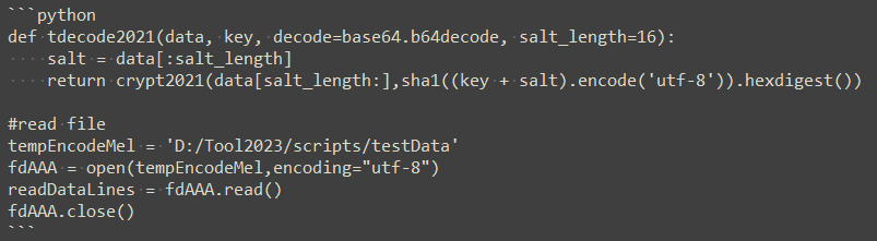

Friendly advice: please post your code using formatting.
To format single words and phrases as code, insert them between single backticks.
To format a block of text as program code, place the text between triple backticks.
After the first three backticks, write the language syntax you want:
