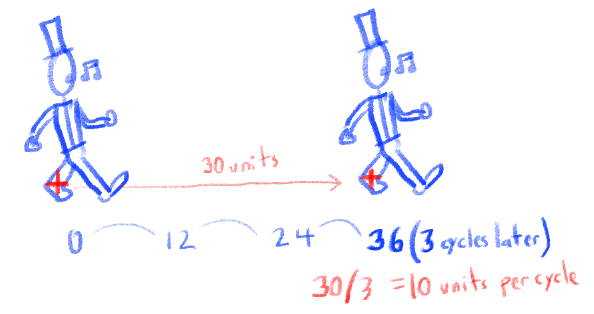

Say you have a walk cycle, moving forward in Z, that loops every 12 frames. Assuming your IK feet and COG controllers are what are animating forward, and the root group or controller of your rig is staying at the origin.
Sample the translationZ of a given controller in world space on frame 0 and 36. (Or 12 or 24 or 96.)
The world translationZ on frame 36 minus the world translationZ on frame 0 divided by the number of cycles you measured, is the distance it has traveled.
If you now animate a world control moving backwards at that rate, your character should be walking in place.
Your IK feet and COG are moving forward just as they were before. But now a world control above them all is moving backwards at the opposite speed.
