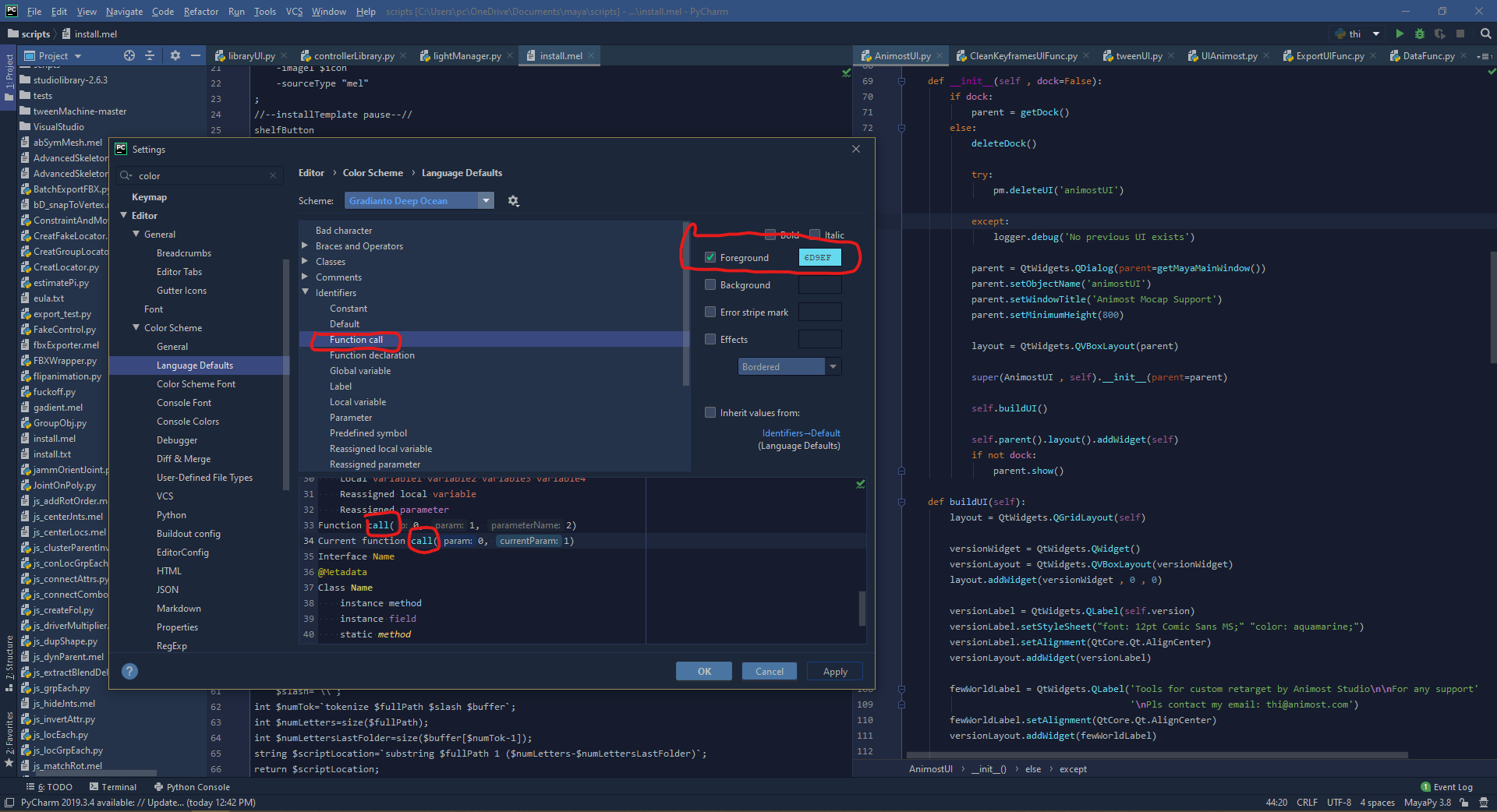

Hey Guys, Is there a way to have maya commands color coded in pycharm?
For example if you type cmds.polySphere() in the script editor, the text polySphere appears in blue. How can we achieve this in pycharm even if its in a different color?

Just so I’m clear, is the goal to get all functions colorized? Or just specifically the ones from the maya.cmds namespace?
just the key words from maya.cmds
So pycharm supports textmate bundles:
You can probably adapt the MEL tmLanguage from:
Basically you just need a standard python tmLanguage file, and add the MEL functions to it (that’s basically what Maya’s syntax highlighting is doing, its looking for mel functions and coloring them, which is why it doesn’t care what namespace you look for those strings in)
There might even be a Maya-Python tmLanguage out there already.
THANK YOU SOOO MUCH!! Thats what I needed!!
