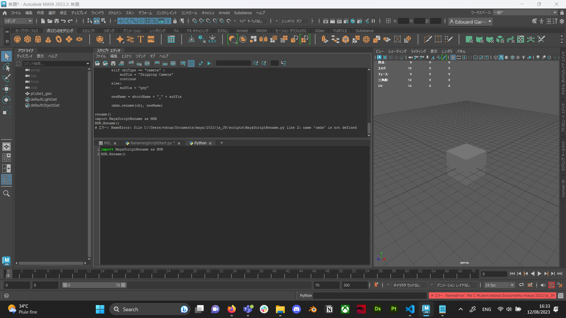

but when i try to import it and run the rename function I get the error “… cmds not defined”
I tried adding “import maya.cmds as cmds” at the beginning of my py file, or in maya before importing, but the issue stays, any idea why?
